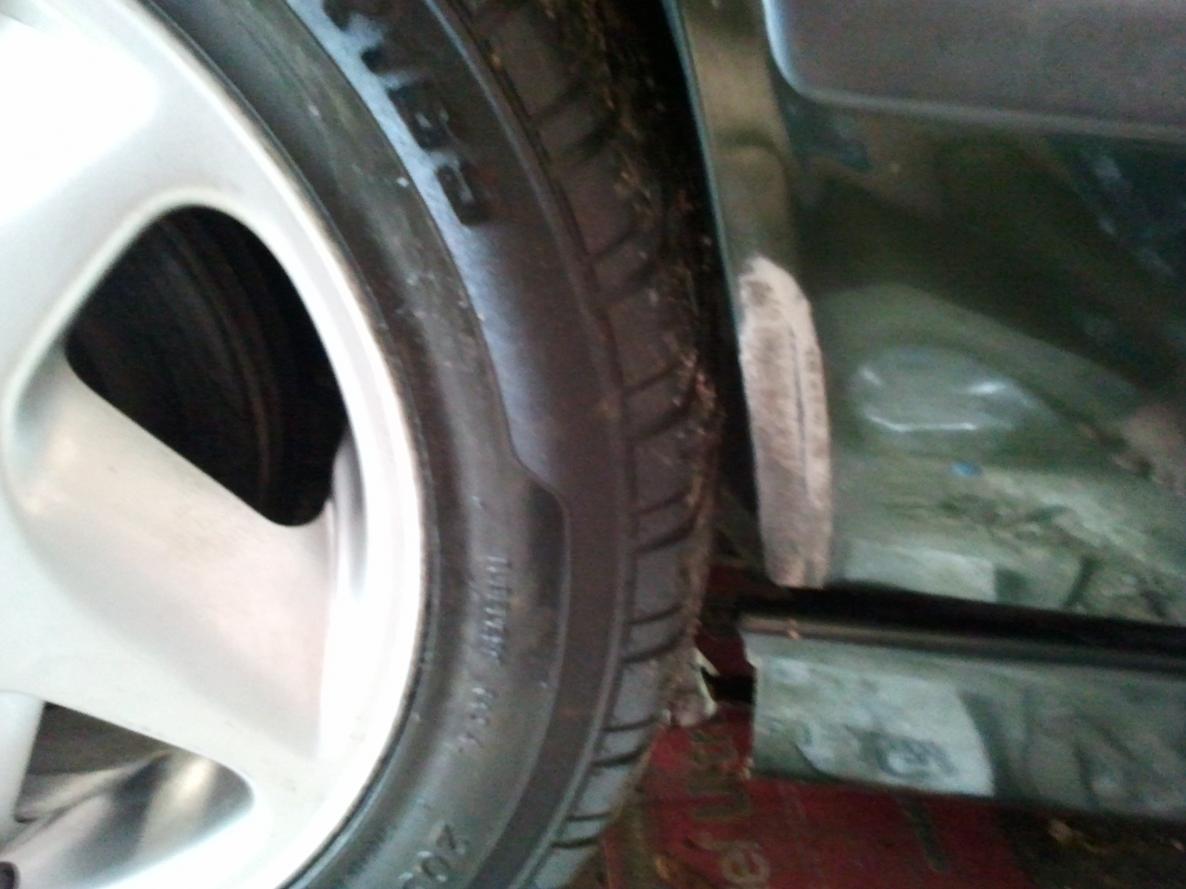

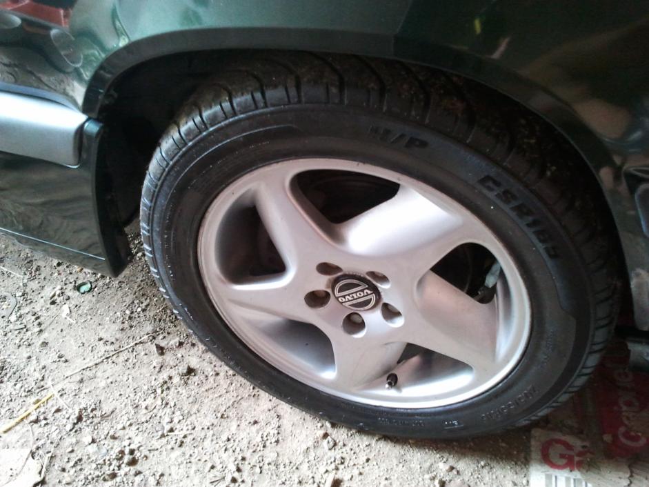

well i do not know why the tires is so close to the fenders caster problems yes i know the reason can someone tell why

Check and see if the previous owner put wheel spacers behind the wheels.

it 16 stocks rims the problem is that the tire is not in the center as normal is closer to the fender

Did you see if there were wheel spacers behind the stock wheel like IB said?
But they dont look any different than mine. and I dont have spacers

is not wheel spacers could be the control arm bushings maybe i remove the left mudflap cause it was real close and the other side have the same issue

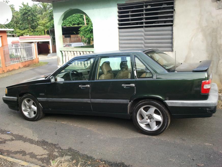

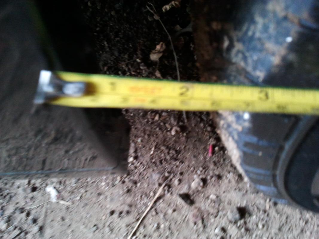

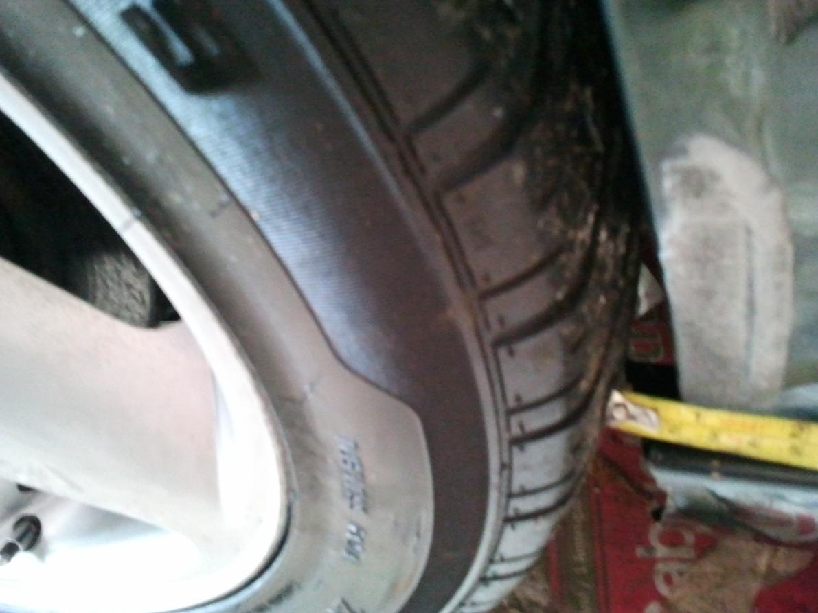

Default this my issue
and yes it damage the mudflap

I see where you talking about now..
Have you lifted the wheel off the ground to check it for play?
When you put it in reverse does the wheel move forward?
could also be a bent sub-frame, or bent control arm..
Have you looked underneath for any damage?
Old Aug 25, 2011 | 05:04 PM

it got a 2 right control arm driver side ok left wrong so i need to get a LH control arm well i buy the car with that issue

205-55-16 but i check it got a RH control arm in the left side well i buy the car that way

205/50-16 is the proper size. The tires are taller than what's originally on the car. That being said, it DOES seem a little off-kilter. I'm running 225/45/17 on my car and they arent that close, and i have 15 mm spacers in the back.
