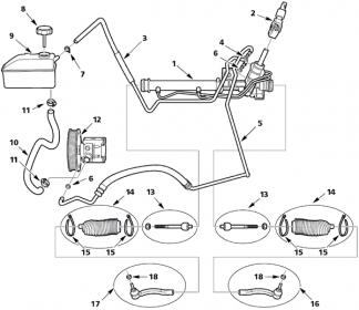

Looking to change the yoke as I have too much play in the lower steering joint where it meets the steering rack. I bought the part a month ago but have been procrastinating as it looks like a nasty access. Any suggestions on how to approach this job?

column no.2 on the diag.

pull out the column. remove yoke from inside the passenger compartment.

Will be easier to drop the rear part of the subframe.

true, only 6 bolts... 8 bolts if u need more room yet.
