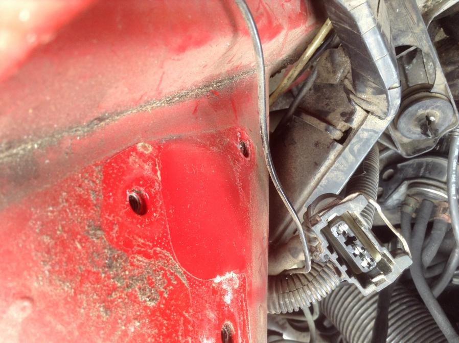

I unhooked the ignition coil plug, when I look in it it only has 3 prongs, there's places for 4, the coil itself that originally came off it, the prong that's missing, the male end is clean, like there never was 4 female ends to it, can't find any info on this one, can someone confirm there's only 3 or should there be 4. Hi wits end, nice to see ya

I posted a pic, but iPad won't let me paste URL here

Go advanced and upload the photo.
Connect everything, pull a plug and see if you have spark going to a plug.

Attached Thumbnails My 850 keeps dying :(-image.jpg
Old Oct 10, 2013 | 03:21 PM
  #18
Ok, that is 3 wires. Did you hook everything back up and see if the plugs are getting spark?
