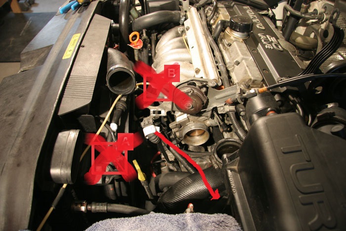

Hey Thanks ! Hmmm it might be from the turbo. ( sorry i'am not really tech savy when it comes to mechanics ) but the turbo goes good and has a nice sound and the engine also. I got a pic on google and made an arrow to point to where the ''hose'' is roughly ( sorry had no time to go and take a pic of it and it is dark a bit today so I guessed that finding a pic would be better and clearer a bit )
But it seems not to leak on the ground so I guess that it is good news
Thanks !

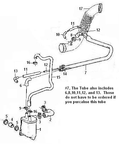

That might be the line that runs from the PCV "black box" on the front of the engine, middle under the intake over to the PTC valve in the intake just in front of the turbo. It's supposed to pull gasses from the engines crankcase out the black box and into the intake to be burned.
I'm just guessing, you need to follow the hose and tell us where it starts and where it ends.

Yeah exactly! it's a kind of black metal ''box'' under or pretty much under the air filter box written Turbo on it. I will follow the hose more tomorrow because my car is outside and it is pitch black here and it is winter :| Thanks for your reply !!

If that's what it is, then smoke should be coming out of it. That's the thinking. When it's hooked up to the pipe from the air cleaner to the turbo, the smoke gets sucked into the engine and burned up. Cause that's how everybody likes it.
