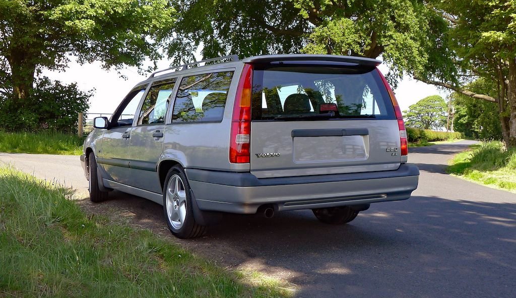

This is my 1997 850 GLT with only 60,200 miles on the clock
