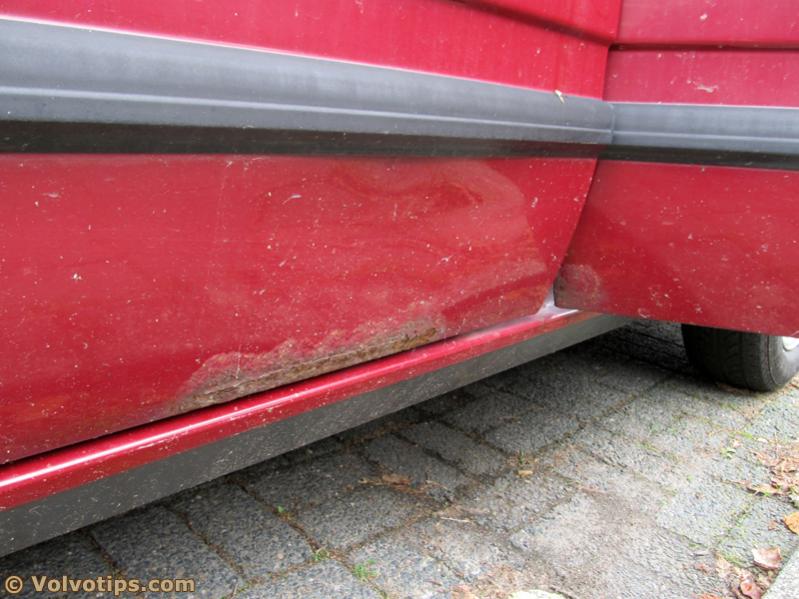

I need to move south! By the time I see a 92 up here there isn't anything left of the bottom of the body from rust out caused by winter salt.
Attached Thumbnails New to Volvos - Looking at 850, Bad Engine-rust-door-bottom.jpg
