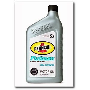

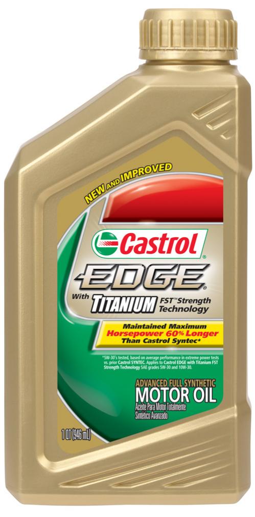

It's just my opinion but Pennzoil is not what I'd call a "high end" motor oil.
Valvoline, Mobil 1 or Castrol edge with titanium would be along with Royal Purple.
Or were you asking about the oil weight ??
Attached Thumbnails penzzoil-oil-qt-reg-penzoil-5w30.jpg   penzzoil-oil-qt-syn-platinum-pennzoil.jpg   penzzoil-oil-qt-castrol-edge-titanium.jpg   penzzoil-oil-qt-royal-purple-10w40.jpg
