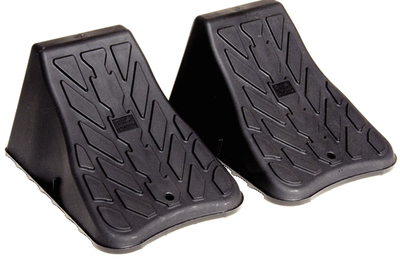

Old Jun 21, 2012 | 08:25 PM
Any time you jack up a tire or tires you should chock the tires so it doesn't have a chance to roll on you, literally
With the average jack you can sometimes find a place in front or back where you can get something solid and raise the end of the car but on new cars there isn't a safe way or a solid enough place to lift both side wheels at the same time.
