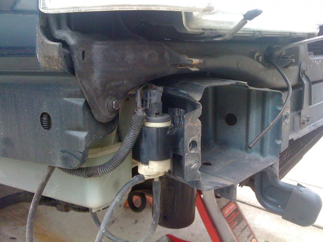

Old Dec 5, 2012 | 02:09 PM
There is a separate pump for the rear washer. It is located behind the front bumper under the passenger headlight and just in front of the bottom of the washer fluid tank.
If I were you I'd pull the connector and have someone turn on the washer while I had a test light in there to make sure it's getting power before you replace the pump.
The front bumper was off for another reason. You DON'T need to pull the bumper to access the pump
Attached Thumbnails Rear washer Fluid sprayer issue-washer-pump-rear-wagon-stock.jpg
