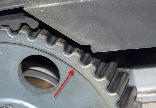

I have reset the belt a number of times. My biggest problem is I could not find the mark on the crank shaft so I rotated every thing and re-aligned the cam shaft marks, then marked where the crank was sitting. I know that was a dumb thing to do but I was desperate. Since I though maybe I was 180 out, I did remove the belt and tried to rotate the crank, it was like you said, I only got a quarter turn til it stopped. Atleast I know I'm not 180 out and so far there seams to be no damage. I will reset at tdc and check the rotor like you suggested. Do you know what the timing mark on the crank looks like and where it might be located? Thank you guys for responding btw.
MattyXXL Oct 16, 2011 10:03 PM
Its a very small mark, looks almost like some poked a notch with a small paper clip...
Here is a post that might help--->http://www.matthewsvolvosite.com/for...hp?f=9&t=27078

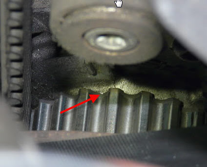

rspi Oct 16, 2011 11:12 PM
That mark is hard to see but here is a photo as well.
http://img.happywrenching.com/volvo/...ark-2-zoom.jpg
If the motor was cranking, it probably was lined up fine. Maybe there was some other problem preventing the start. If you turned the key and it was not lined up properly you likely would have heard a horriable sound of valves hitting the pistons, etc.
boxpin Oct 16, 2011 11:54 PM
2 Attachment(s)
Its tough to see, here is another picture
Attachment 18874
Attachment 18875
