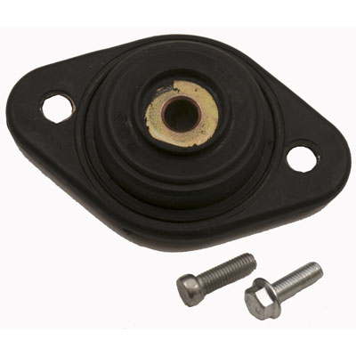

I have KYBs for the last two and half years. No problems, no complaints they seem to ride "average" for me. Not soft and they don't feel harsh either.
I bought the vehicle with a blown mount which was causing a knock in the rear no one could find. Replaced both mounts and added the KYBs and a set of sport/lowering springs. Rear suspension, very happy
