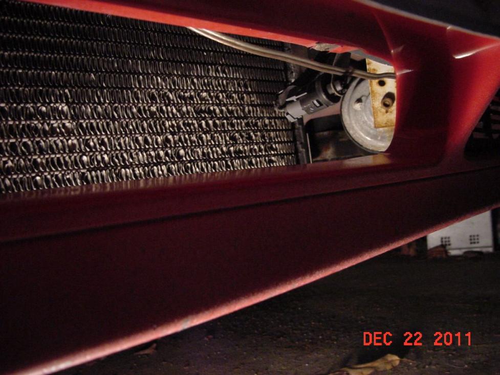

Is it that thing (up arrow) that fits here ??
Attached Thumbnails Smooshed something electronic on a bumpy road-ambient-air-temp-sensor-mounted.jpg   Smooshed something electronic on a bumpy road-ambient-air-temp-sensor-mounted-2.jpg

Well , , , this sensor is about the only thing I can think that's down there. In the picture you see a horn but that's my car and I relocated the horns down there to get them out of the way of the radiator. The ambient temp sensor (outside air temp) needs to be someplace it's getting air and reading temperature that isn't affected by the engine or radiator's heat. It's mounted above the lowest part of the front bumper valence. It's mounted behind it and slightly in front of the AC condenser so it's in a protected area that no engineer thought someone could drive in such a way as to "smoosh". To hit a bump or pot hole hard enough to get to this sensor you'd pretty much have to have smashed the frame all the way to the ground and damaged the condenser and radiator. Not to mention scraped the hell out of or broken that front valance panel.
Because of the way it's shaped he may think it's broken or snooshed due to the short part of it that sticks through the mounting bracket when in fact that's the way the part is That would be good news.
Here in Minnesota there is the danger that someone who is lazy and doesn't shovel their driveway might try to push their car through a mound of snow at the end of the driveway from the snowplows. Now that can cause some damage if that one or two foot mound isn't powdered snow but slush and ice.
Best thing to do is to find out if his car is leaking coolant and if he can get an accurate outside temperature reading from the trip information panel in the center of the instrument panel. If it's not leaking he's good till he gets back and can read this thread and see if that's the part. If he can't get an accurate reading then it's likely this is what he's looking at and it might be damaged.

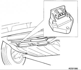

Sounds like the accelerometer to me. That would certainly turn on the check engine light. Its purpose is to tell the engine computer that it hit a bump. when that happens, if spark knock is detected, the computer ignores that, and assumes the spark knock was actually the bump. Very strange. I don't suppose any non-volvos have a thing like that, at least I never heard of it.

Look like this?
Volvo Acceleration Sensor (850 C70 S70 V70) - Bosch 0273101021 | FCP Euro

Found another picture on this forum:
https://volvoforums.com/forum/attach...3630_sense-jpg
If I was a rock, that's what I'd break....

Acceleration sensor $304 Hope it's not this.
