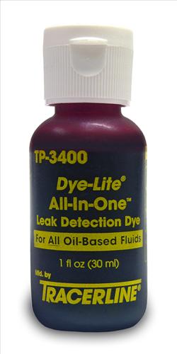

  #17
If all else fails take it to a car wash and spray down the engine to clean it up some and then start inspecting it each time you get back home after driving. You could also add an engine oil dye that will glow under black light to show you new leakage coming out of the engine.
As fast as you say yours is leaking it shouldn't be that had to follow that trail up to the point of origin.
Attached Thumbnails Strage oil leaks-dye-engine-oil-systems.jpg   Strage oil leaks-dye-leak-detection-black-light.jpg
does he have to add it to the crankcase?
Old Mar 13, 2013 | 01:49 AM
  #19
Yes. You just pour it in. You need to make sure it's the right stuff. The directions will tell you what fluids it mixes with. I know some are dedicated like AC dye, some for diesel engine oil, cooling systems but I've see some that you can use in most oils like engine oil and power steering and transmission fluid.
Then you can head off to a hardware store and get a black light and you're good. That or you can buy the little 15 dollar kit at a auto parts store with a black light flashlight and the yellow glasses that enhance the glow.
