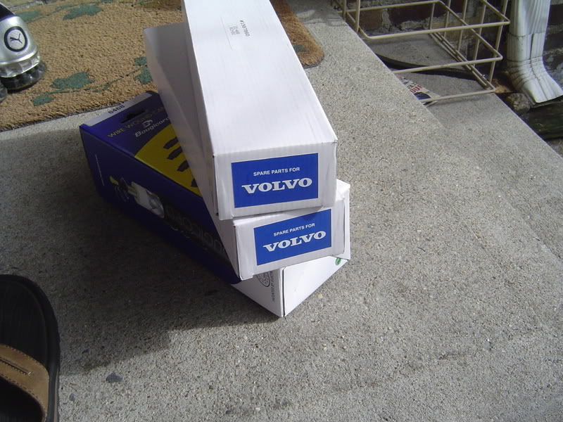

SirBLaughs Feb 8, 2008 01:06 PM
RE: Sway bar end links
1 Attachment(s)
Attachment 23932
Well i just installed new OEM endlinks.
I first started to change my brake pads(not pictured) then i realized, "I dont have that special tool to remove the caliper!" So then i proceeded to change my spark plug wires(which had a stamp saying -92- meaning 1992 [:@]) and spark plugs. Right after that I searched my garage for that piece but couldn't find it with the mountain of Honda parts in my garage. [8D]
After debating what to do, i took my Volvo to my shop and they told me i also needed sway bar bushings because even with my own inspection it looked like i needed them. 40 mins later everything is done and guess what? NO MORE CLUNKING!!! i'll install the bushing some other time. I dont think i need them now!
just wanted to share my experience. :)
