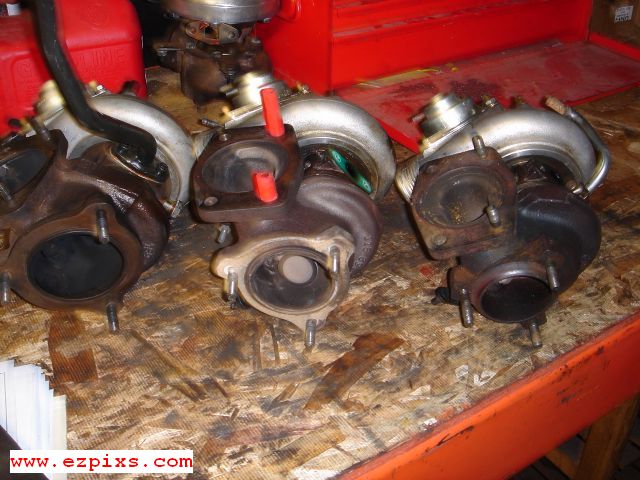

Hi, is there any way to convert a conical flange to either an angled or straight? Don't really wanna put a whole new turbo in..
Old Feb 27, 2013 | 11:53 AM
You can swap just the exhaust housing. But I don't know of any way to convert it. Had a conical on my 95, replaced the housing on mine.
You would need to take it off the car to be safe. It's likely you might want to just purchase a used one at the salvage yard but it's also a great time to take it apart and rebuild it.

okay. i hope ill be able to come across one at the junk yard... thanks!
