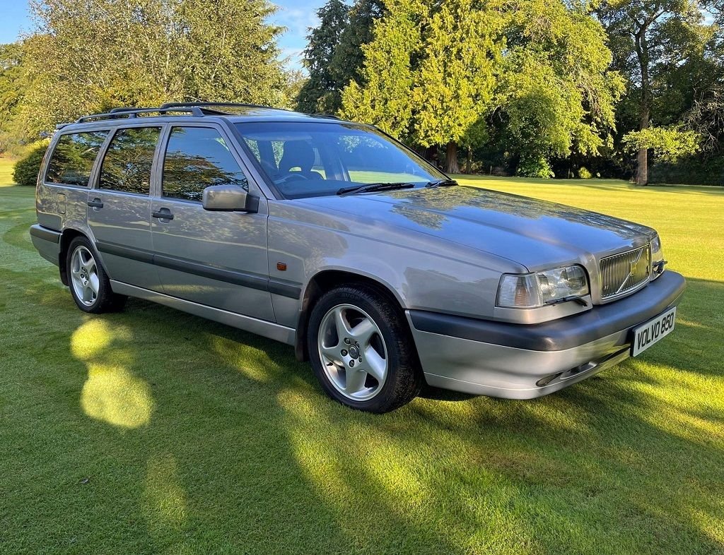

An popular option when these cars were new was Volvo Columba 16" wheels with 205/50R16 tyres... NOTE 205/55R16 tyres will rub on full lock
If you go for Volans then 205/45R17 with blue spacer blocks will be required to prevent rubbing
This is the Volvo Columba 16" wheels

I'm running 215x45x17 on Propus and my car is lowered. Just checked my wheel wells and there are no rub marks. YMMV (Parsnip, is that your 850?)
Old Feb 3, 2023 | 12:39 PM
BelgianSwede's Avatar
Joined: Jan 2022
Posts: 23
Originally Posted by tonyfr
...(Parsnip, is that your 850?)
Yes Tony

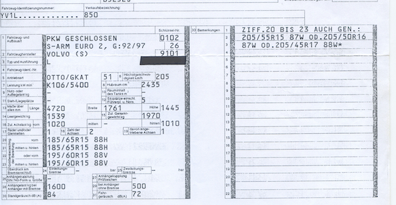

Here's a print out from Volvo for factory tyre sizes
185/65R15
195/60R15
205/55R15
205/50R16
205/45R17
