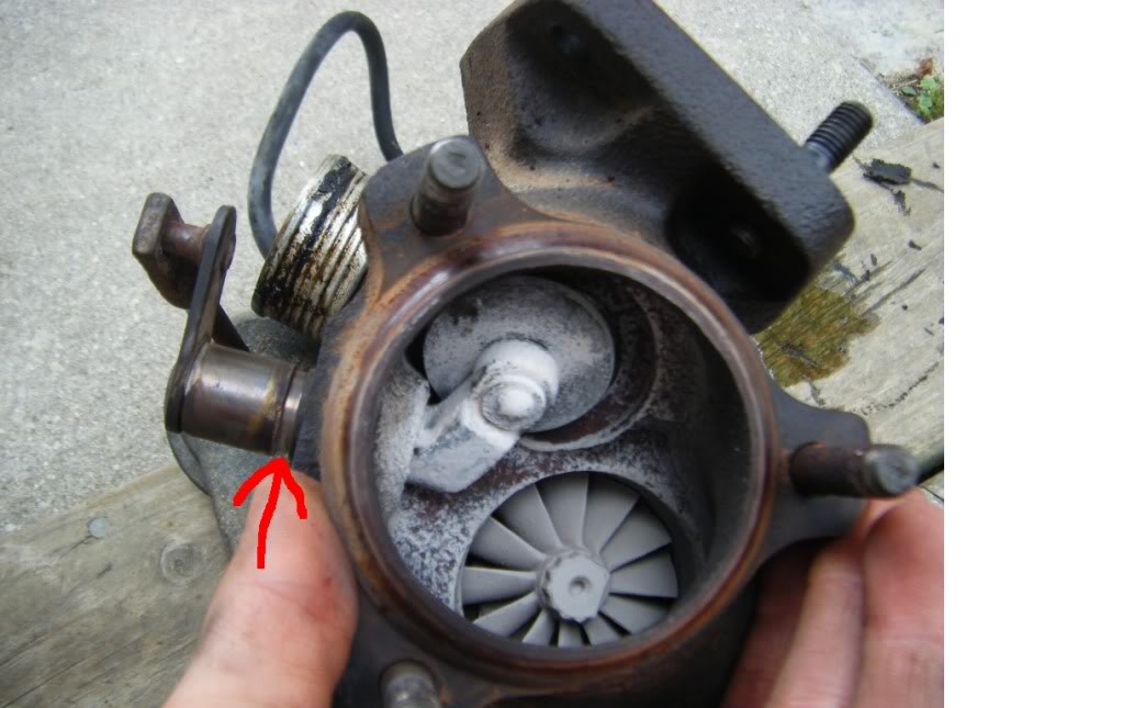

Look at where the waste gate rod connects. See if the part the rod connects to walked up some.
If it has the gap like in the picture it did walk up and it need to be tapped down some.

Well the shaft is flat against the turbo. Are there any neat tricks to track down vacuum leaks?
