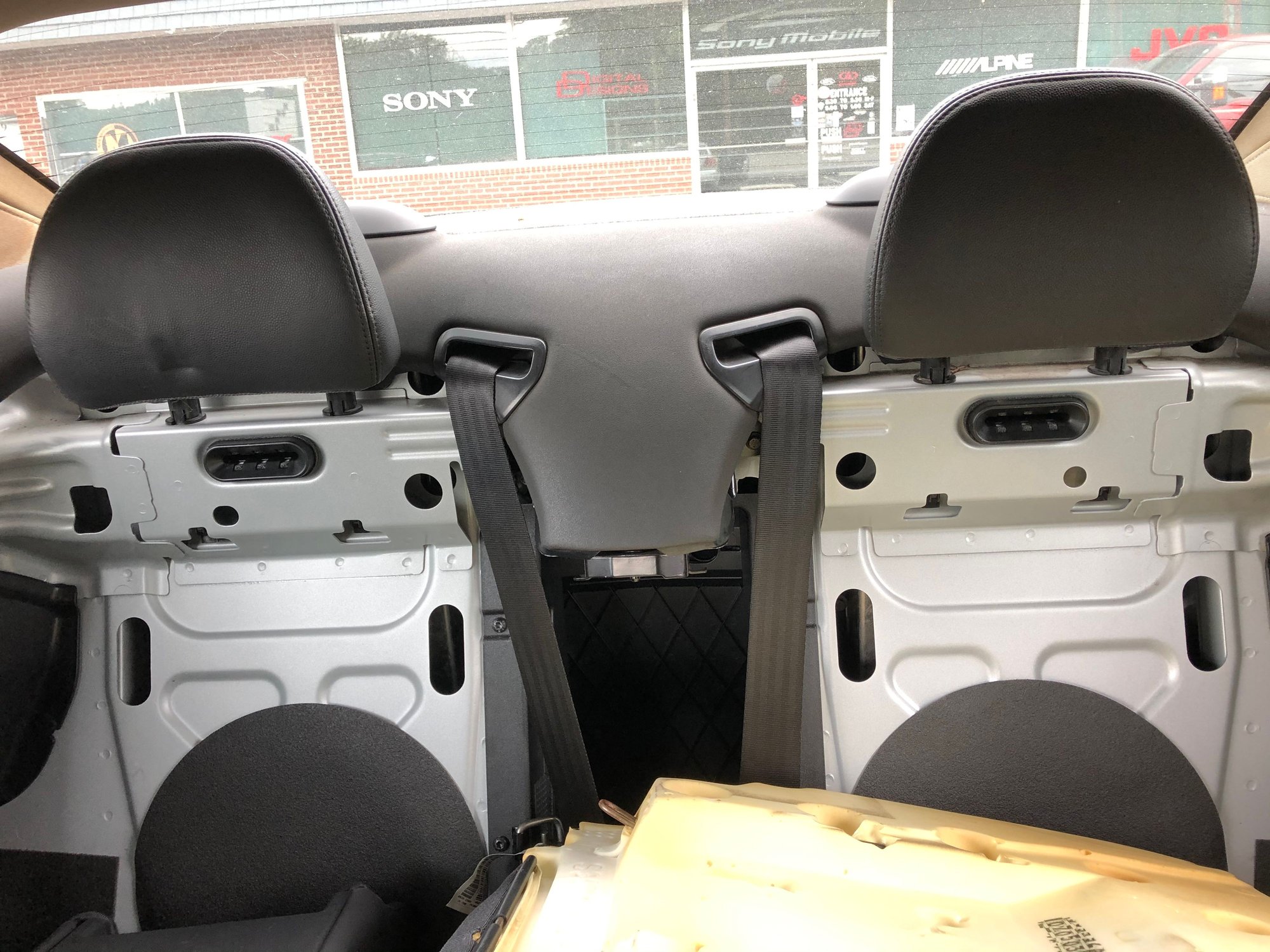

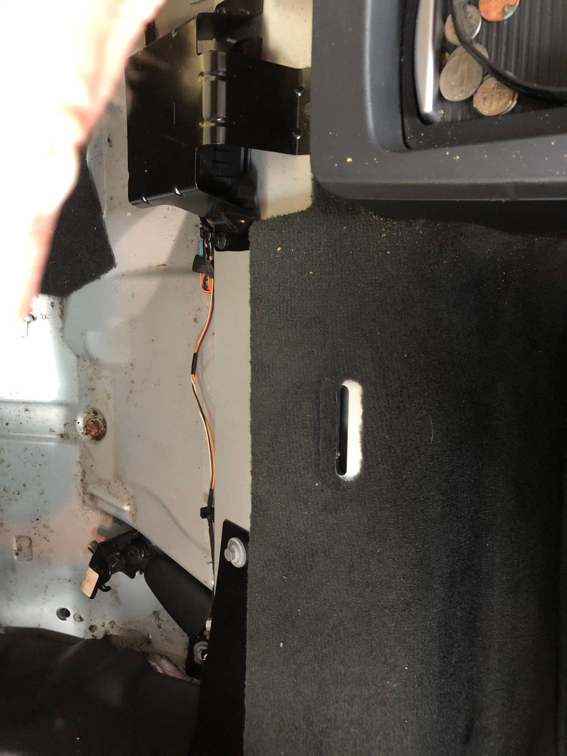

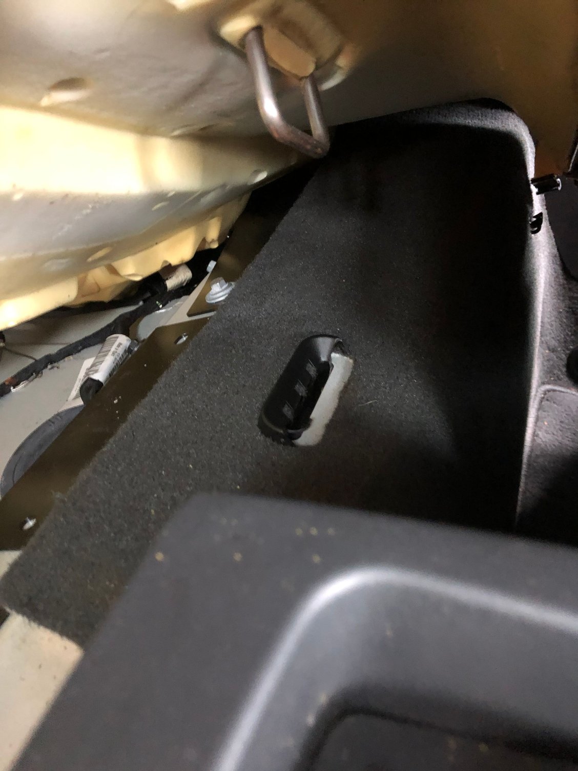

yes I was able to get the seats out. The bottom seat is connected at the center of each rear seat and just pops up will a stiff pull. The backseat seats are connected at the top right up under the head rest the same way the bottom is. Just pull from the top of the seat and it will pop off.
Notice the slot. That’s were you pull up
The slot at the top under each headrest is where they are connected. Just pull from that area.
This is the other side of the bottom. Just pull up
