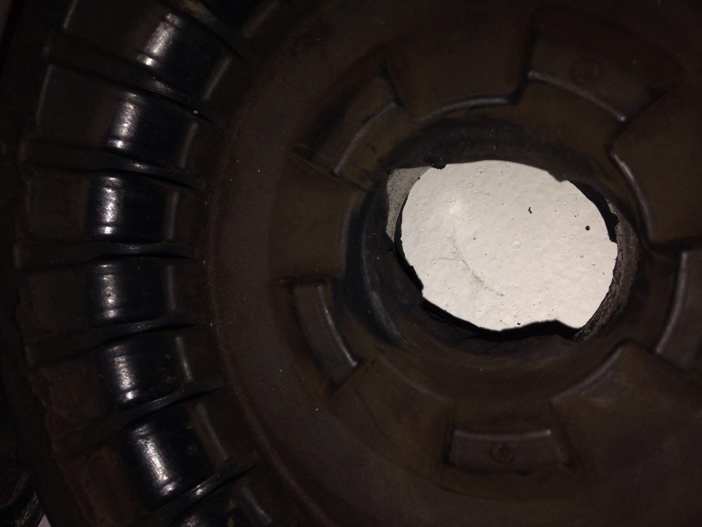

So I got it fixed today. Found a shop that would take my parts. Charged me $200 labor and they did not mess with my alignment. So got it done a lot cheaper.
Was also told that the other side is "worn out" and the sway bar end links need replacement and that the upper engine mount is going bad.
I did hear the drivers side "thunk" over bumps and there's also a rattle while going over the bumpy roads.
Edit: Just checked sway bar end links - they seem firm. No rattle. I thought if they clunked meant that they were going out. Correct?
Question is: how do I check the other side spring seat? I tried to look at it without jacking the car and it's almost impossible to look at it.

You can't replace a strut without messing with the alignment.
How did you check the links?
Use a 21mm on the top nut. If it turns all the way, the mount is broken.

I grabbed them one at a time and gave them a hard tug. No movement and no clunk/rattle or any sound. They were very firmly in place. I had changed them about 25K miles ago - which is why I am more confident that they should not have worn out (granted that they were cheaper replacements).
I just checked the invoice - $50 out of the total was for 2 front wheel alignment. My bad.
I will check the top nut tomorrow after class.
