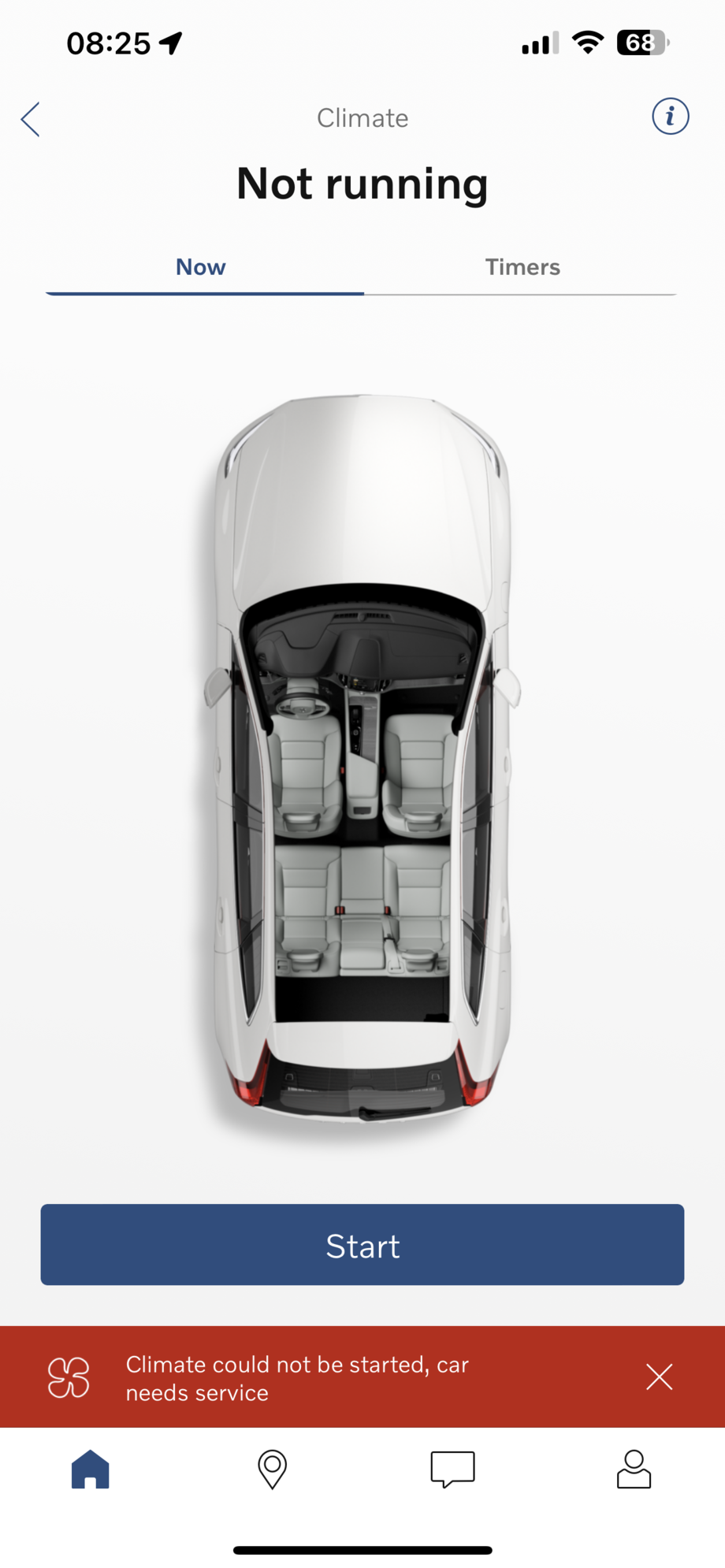

Last week I tried to turn the heater remotely with the car connected to my house charger and received this message on the app.
Have you guys received this notification as well when you were experiencing the problem with the auxiliary heater on pure mode?
Yes. in my case I also saw it once on the dashboard.
