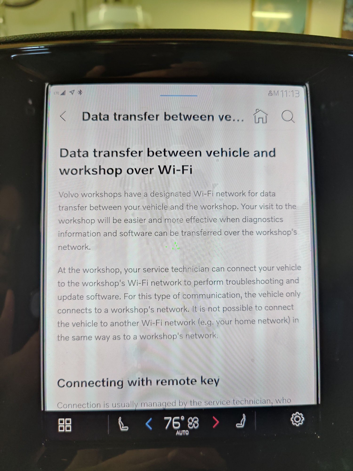

Customer Care had me do a reboot of the LTE system by holding down the left defrost button for about 30 seconds. That worked while I was sitting on the car (on my phone), for a few minutes, but now that I'm back inside it disconnected again.
AT&T stinks here and I understand that's who they use. That, plus our car is in the garage.
It seems I can't use Wi-Fi to connect the car at home. Actually, it connects, but one time only and drops. Apparently, Wi-Fi isn't used as a backup for LTE per what I read in the manual.
And what's a workshop? lol. I presume they mean a service center.
Wi-Fi in car
