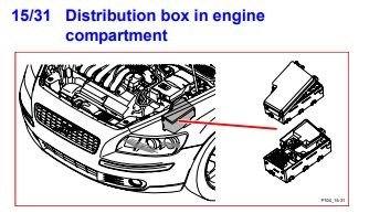

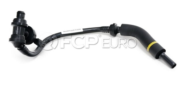

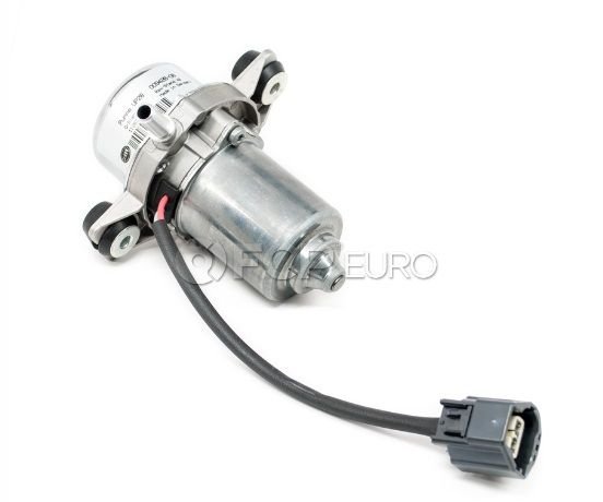

Remember the diagnose rather than guess part? You have heater codes on BOTH O2 sensors, B1S1 and B1S2 - that is bank one (you only have one bank) Sensor 1 (front), and sensor 2 (rear). So what is common between the two sensors?
Looking at the wiring diagram - both sensor heaters are powered by fuse 33 in the fuse box 15/31 under the hood. Note that fuse also powers the brake vacuum pump. A common problem is the brake vacuum pump switch breaks, (if equipped) ,turning the vacuum pump on and it runs all the time until it overheats, melts, shorts out and blows the fuse. So the problem could be there is no power getting to the heaters due to a blown fuse caused by a melted/shorted vacuum pump and a broken vacuum pump switch. Do you have a blown #33 fuse? Does your vacuum pump work? (turn key on, engine off, depress brake pedal a few times - you should hear the vacuum pump buzz under the hood) Sample Vacuum pump and switch pictured below.
