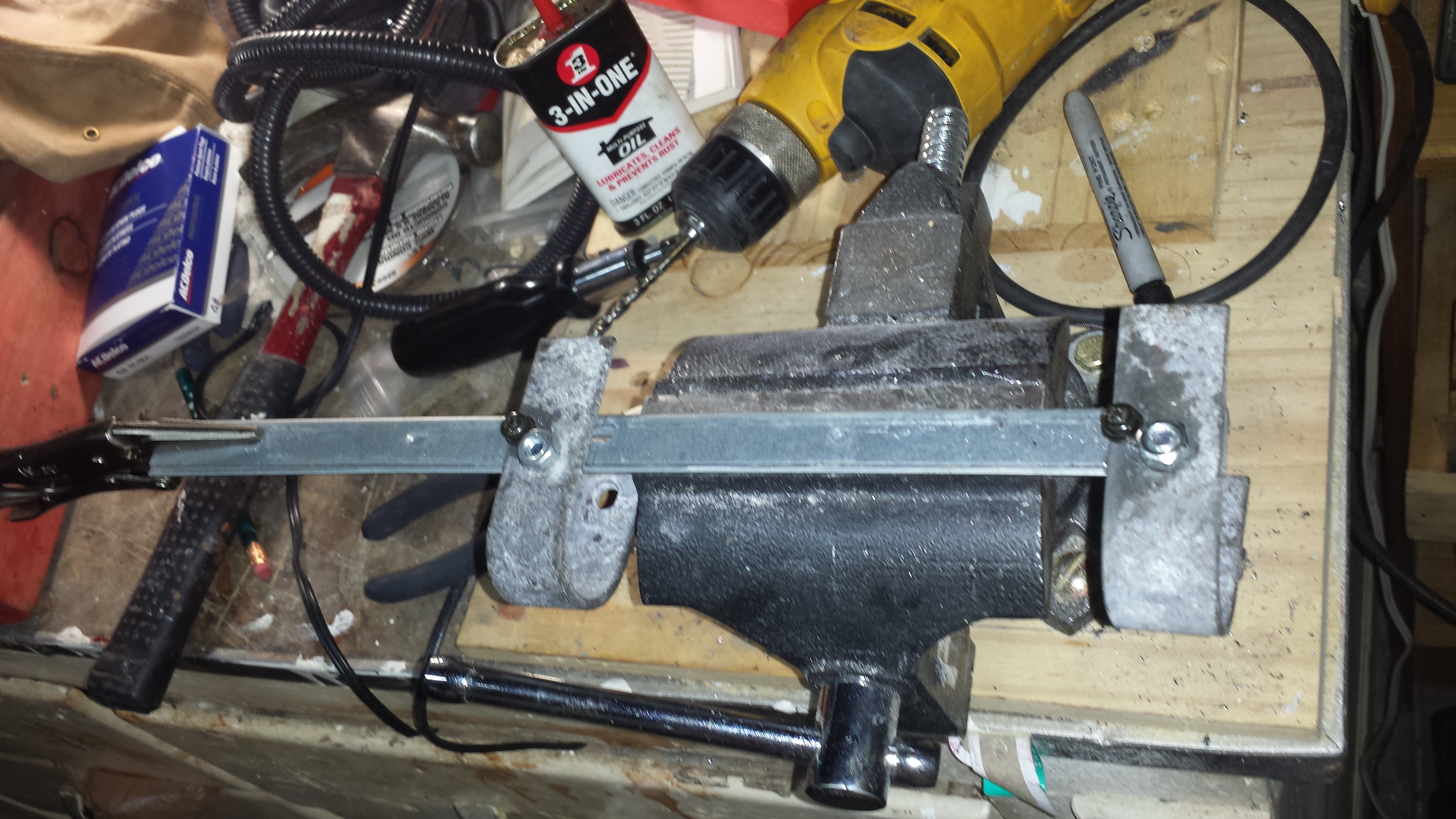

Photo 2 - homemade cam alignment tool v1 (bent it trying to remove the exhaust cam gear so v2 is reinforced - though still it broke and instead I had to remove the outer toothed ring and some of those stupid looking bolts that blocked the head cover from coming off.) Used vise-grips. Anyone seen a socket for that?
