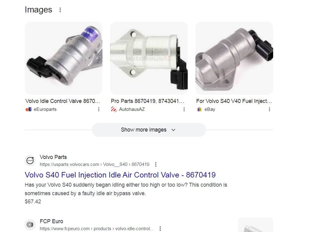

The device shown below is your IAC/idle motor/air bypass valve - whatever you want to call it. I have replaced many bad ones on the s40s because - the engine won't idle. Yours might be bad. (could also be an air leak or some other problem)
