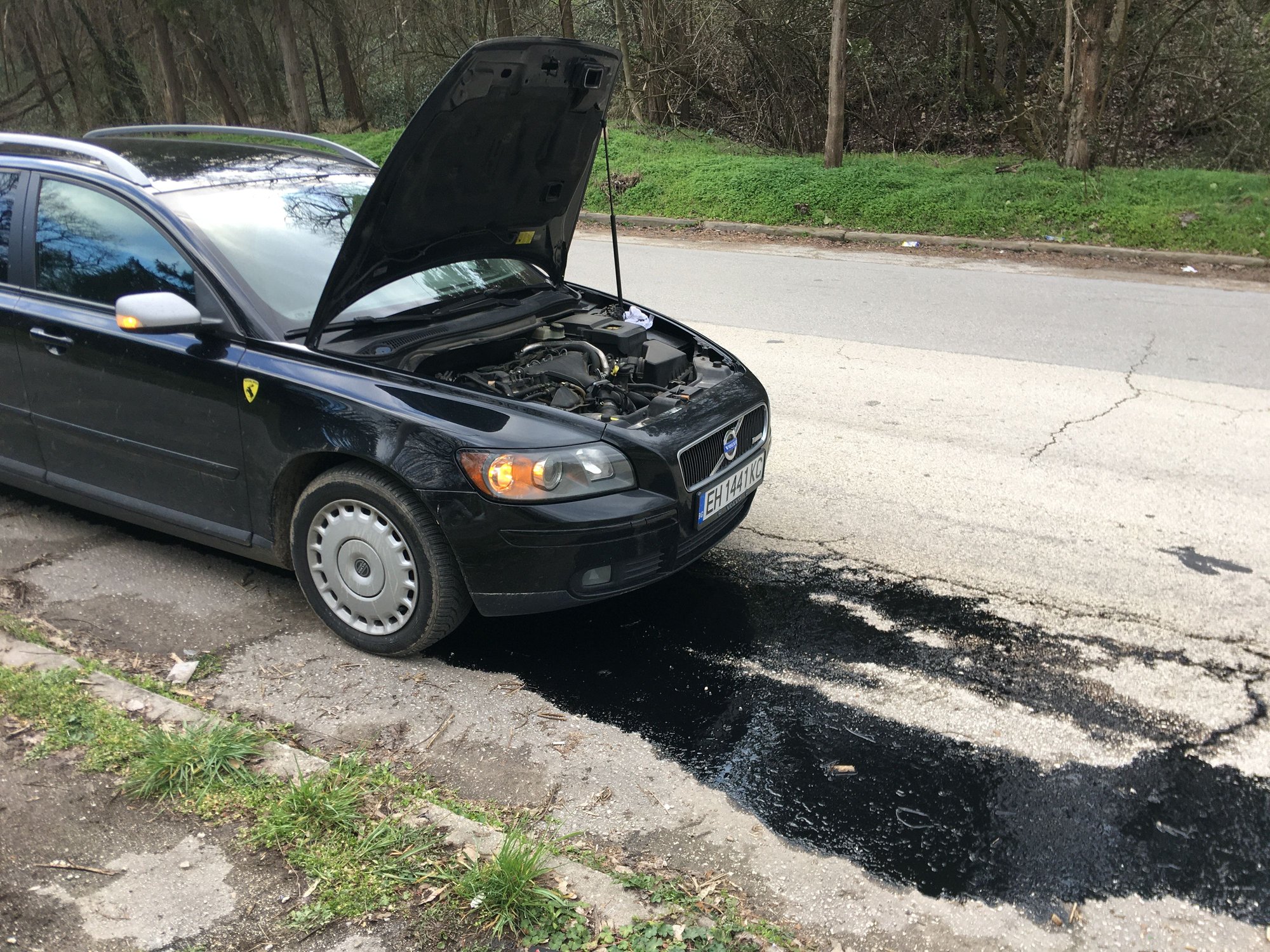

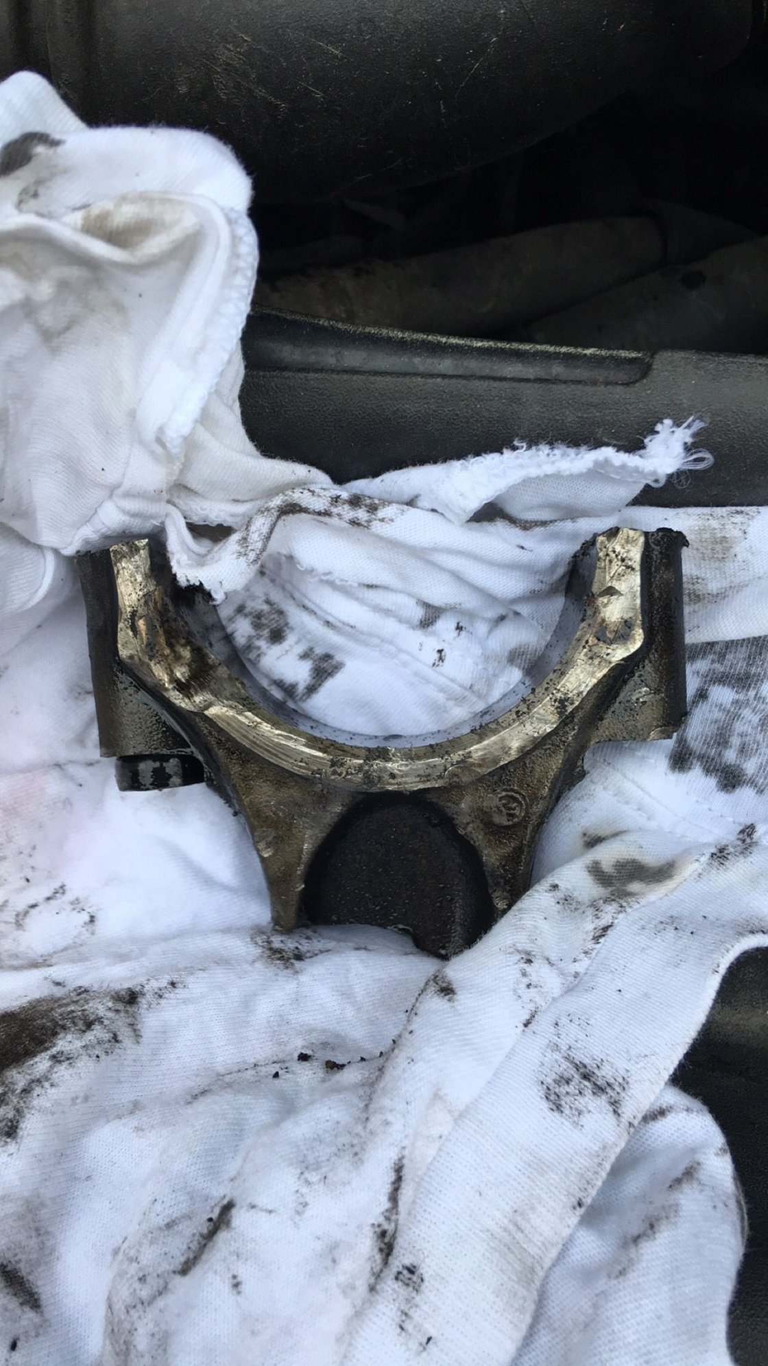

I am looking to replace the engine of my VOLVO V50 and I was wondering if the engine from other cars (such as peugeot, ford or citroen) is compatible or my car or it HAS TO BE from another Volvo

And please, let us know what caused your old engine to grenade like that...
