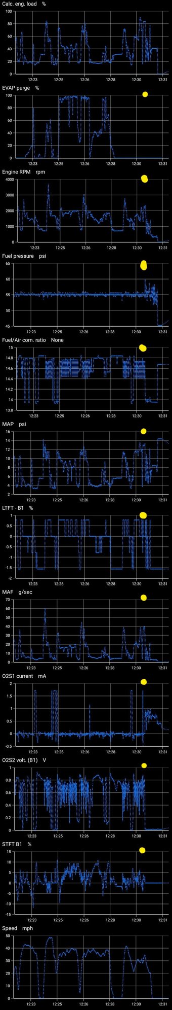

I've attached some graphs of info I could grab, the yellow dot is exactly at the time the misfire and error message occured. Does anyone know if this could simply be a malfunctioning fuel pressure sensor? Does the EVAP code have anything to do with it? In the graph you'll notice some immediate fluctuations in readings when it happens, so I'm hoping someone on here can help me narrow down the problem, I've put a lot of work into this car recently and can't even enjoy it because it's scary as heck to drive anywhere haha

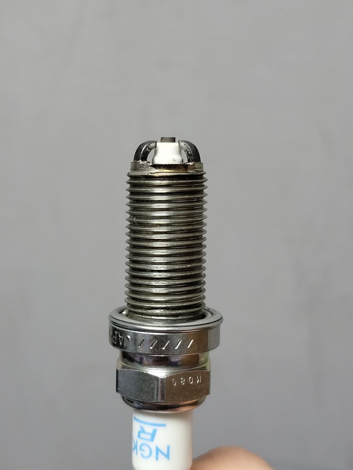

I'm not sure how to check the gap on this kind of plug, the box said pre gapped to 0.028, but does this look right?

Yeah, those are usually gapped per spec, since they don't have the little L-shaped ground anode to bend in transit. That "old school" plug was really (!) easy to mess up.
