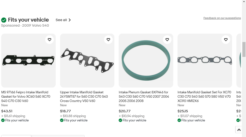

I'm going to give this a try.. but I'd like to replace some parts like the Intake Gaskets, if I'm going to take the time to remove some things. Anyone know the Part Numbers or have a Link for the Parts?
I See a Variety of Gaskets which say they fit my car on eBay... Though I am quite Sceptical that some of them are even used on my car?!
