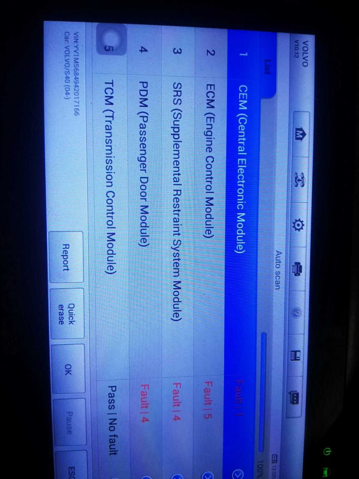

The car lost power a couple of days ago and I can't tell what's going on. There was an SRS Service airbag armor that was caused by 2 plugs I disconnected while cleaning the floors and forgot to put back but eventually did. The diagnostic machine says a couple of things but most of those error were cleared and didn't seem to come back to bother again I have attached most of them.

since your car has presented a happy-meal of fault codes, you can do a few things to help elimininate some of the noise - 1) write down then clear the codes. If something is truly broken, the code will reset. 2) check system voltage. low voltage events can set off false positives 3) find a wiring diagram (or get a VIDA CD) and start looking for common points (fuses/relays) on the various modules/devices reporting bad behavior. Check said fuses/relays and ground points.
