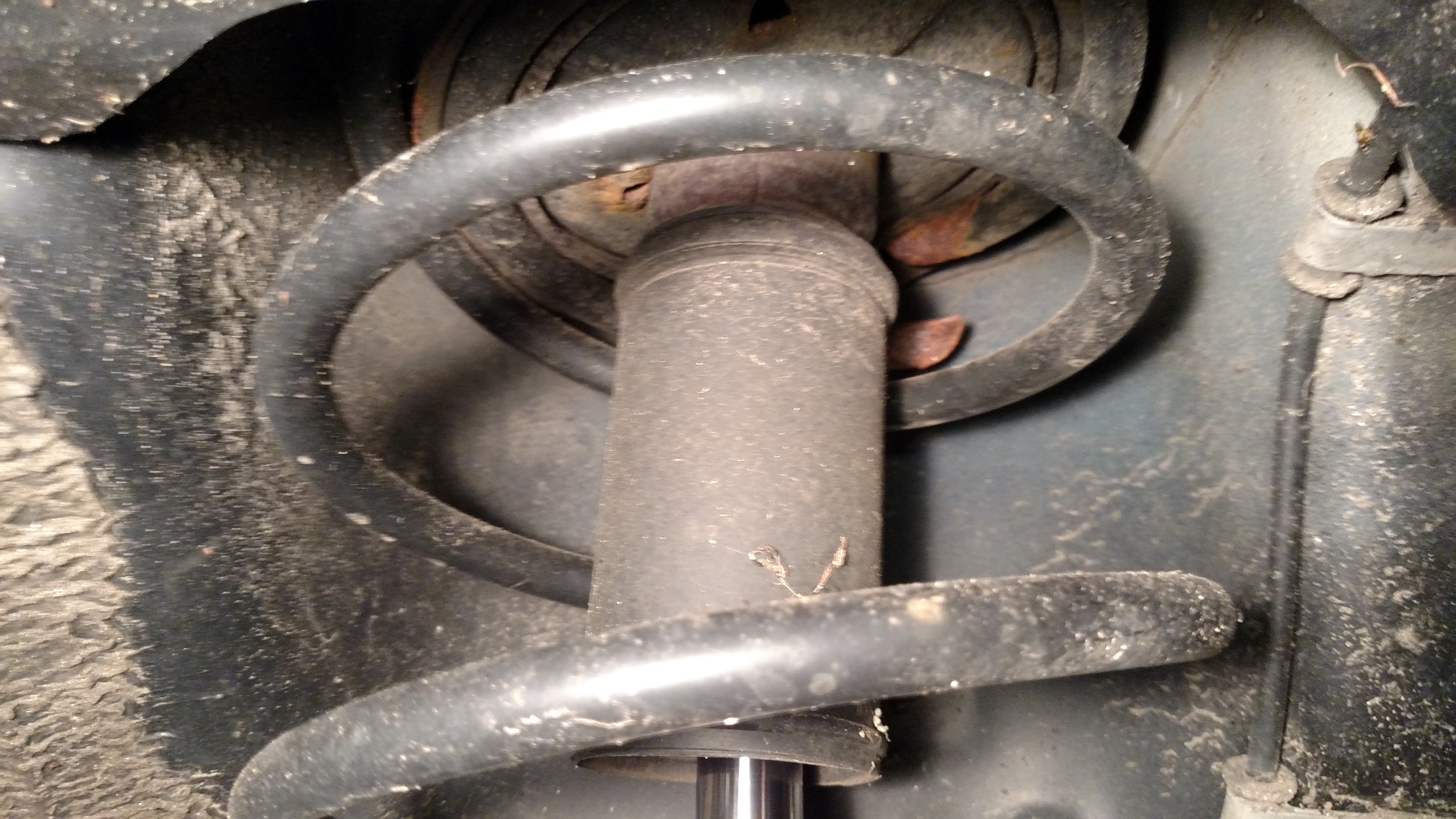

I'd also check your tires - is the pressure too high now that its warmer out? Also if the tires are over 5 years old, the rubber may be firming up as well. Regarding the springs, they are a separate issue from the struts/shocks themselves. Generally they don't wear out or firm up but in the case of the S40s they just break off the last 3 inches. Best to inspect each spring front and rear, particularly the ends up to near the spring seats. I've had 3 out of 4 break on my 2000.

The springs hold the weight of the car. The shocks and struts stop the car from bouncing on the springs. That is the reason for the push test. A good working shock should stop the car from bouncing immediately.
Also look for fluid below the bare metal plunger part of the shock/strut. The body of the shock should be dry and not have any oil leaking onto it from above.
