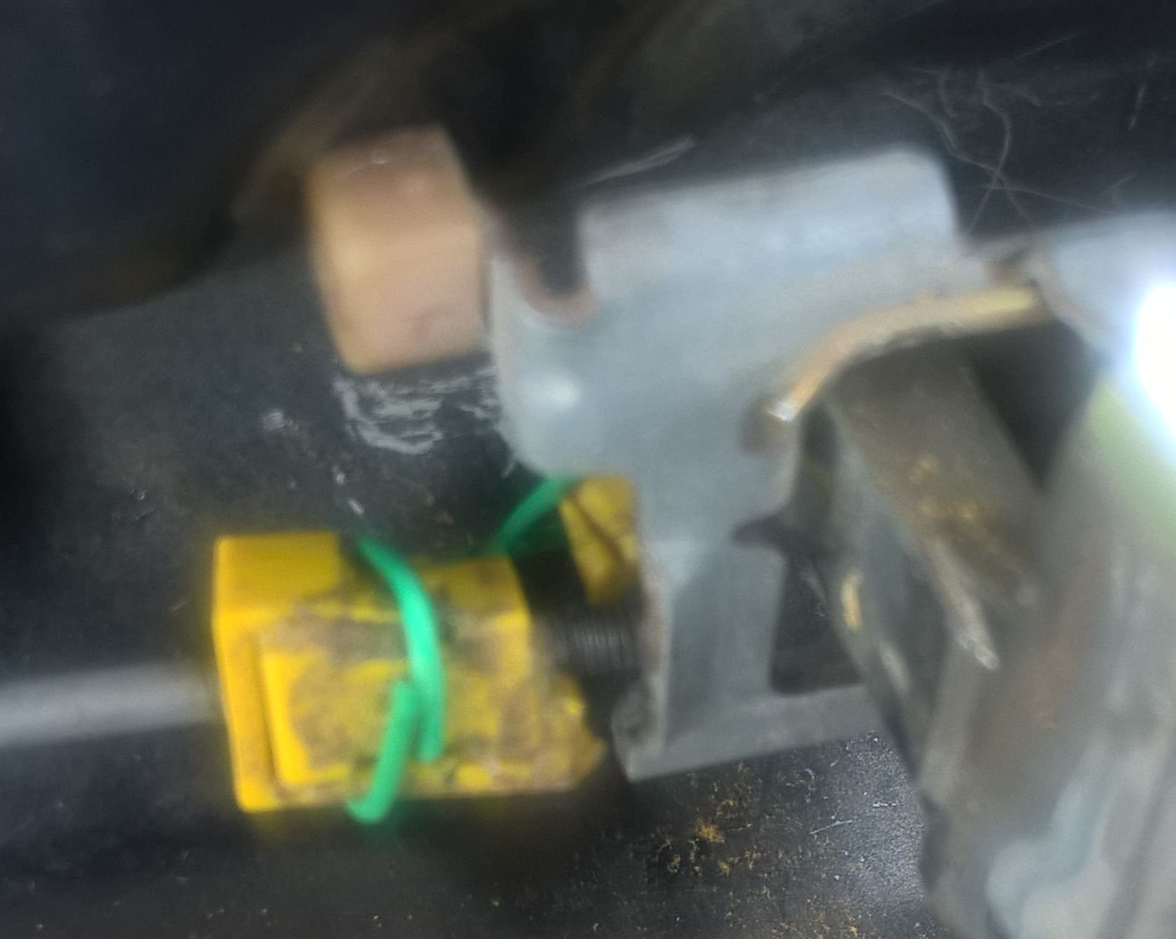

Not sure if anyone still needs this or may need it in the future BUT I did a MacGyver on mine with a paper clip and it works better than original. If we are talking about the yellow plastic piece that screws onto pole that goes over to door lock, sounds like same problem.
Mine was not completely broken so first I tried to place a metal bracket on top, that did not work, too much play still and I ended up breaking mine completely. So I had one piece that pops into back of handle, I took my wire clippers and clipped it even where it broke, Then I drilled a small hole in it, I took my paper clip and fed it thru and twisted it good, I then had to drill a hole into piece that screws into pole/lever, fed it down and wrapped it around twice, Viola, works better than before.
