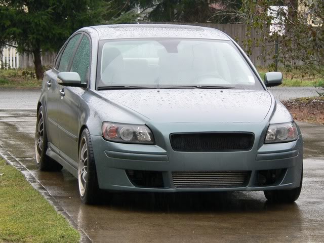

With the coilover issue your having, and the springs being cut, I really think your gonna be S.O.L. there. I'm sorry and I know it sucks. IIRC your wanting to raise the car, correct? I would take the coilovers off the car and install H&R sport springs. They'll still give you an aggressive drop but it they aren't harsh at all.
My old S40 with H&R's
