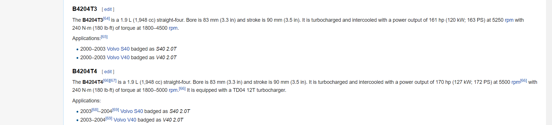

Thank for your reply! Does then Gen 1s go through early 2004? I have a ECU from a 2002 s40 and want to put it in a early 2004 s40. Difference is the 2004 is 170 horse power and the 02 is 161 hp. Both are 1.9t Badged as 2.0.ECU Module Swap-screenshot-51-.png

yes the gen 1s include the 2004 model year. The gen 2s are 2004.5s and the newer body style. A quick check of the part number should show they are the same.
