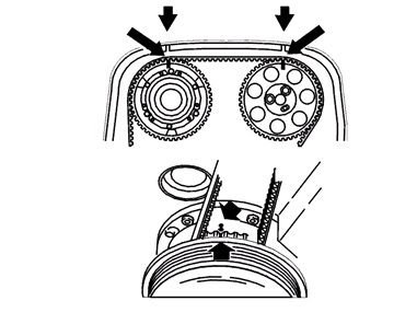

Yes - your first step will be to either do a compression test or line up the crank and cam timing marks to verify the cams are timed correctly. Unfortunately a common occurrence when the serpentine belt shreds is some of it gets under the timing belt and puts the cams out of time with the crank,
All of those sensors/ coils/wires are not going to go bad at once - the cam, crank, and coil codes don't mean those parts are bad - they mean the signals are incorrect - like maybe happening at the wrong time because they are not timed properly .
Out of a hundred or so timing belts I've seen that have come off or "slipped" - only one has not resulted in bent valves, it was only a couple of teeth off - so there is hope that the valves are not bent.
Here's how the marks should line up - and it sounds like you have the 4 cylinder s40 where the front engine mount is in the way to get to/see the crankshaft marks. Crank mark is very difficult to find - the 2 marks on top of the teeth of the crank gear. that line up with the bump on the oil pump housing

in relation to the gears of the top two it seems lined up, as for the bottom i havent been under any further than i have too. picking the car up is the next step in this wonderful adventure of volvo. Im a rock guy staging is my game heavy truss sling car lift with chain motors .........wheres the rigging points on this thing?

The crank gear is viewed from the top, you don't need to lift the car - but you will need to support the front (left side ) of the engine when you remove the front motor mount bracket to be able to get to the timing belt.
A floor jack works nicely.
Or get a compression gauge - test the compression - if the timing is off enough it will have 0 or close to 0 compression - that info will tell you what needs to be done.

how would you tell they all line up without manually turning the cam and crank. if the engine has been running for years and the marks have rotated so many times? so is there a number of teeth on the gear that can be counted? The top two are easy. if they are the same in relation to the marks. A.----- B.-------- C.----------Right timing?

Put a socket on the crank pulley nut, spin the engine clockwise until the crank marks are lined up. Then see if the cams are lined up also.
The marks on the crankshaft timing gear are very hard to see! just two notches on the tops of two teeth
