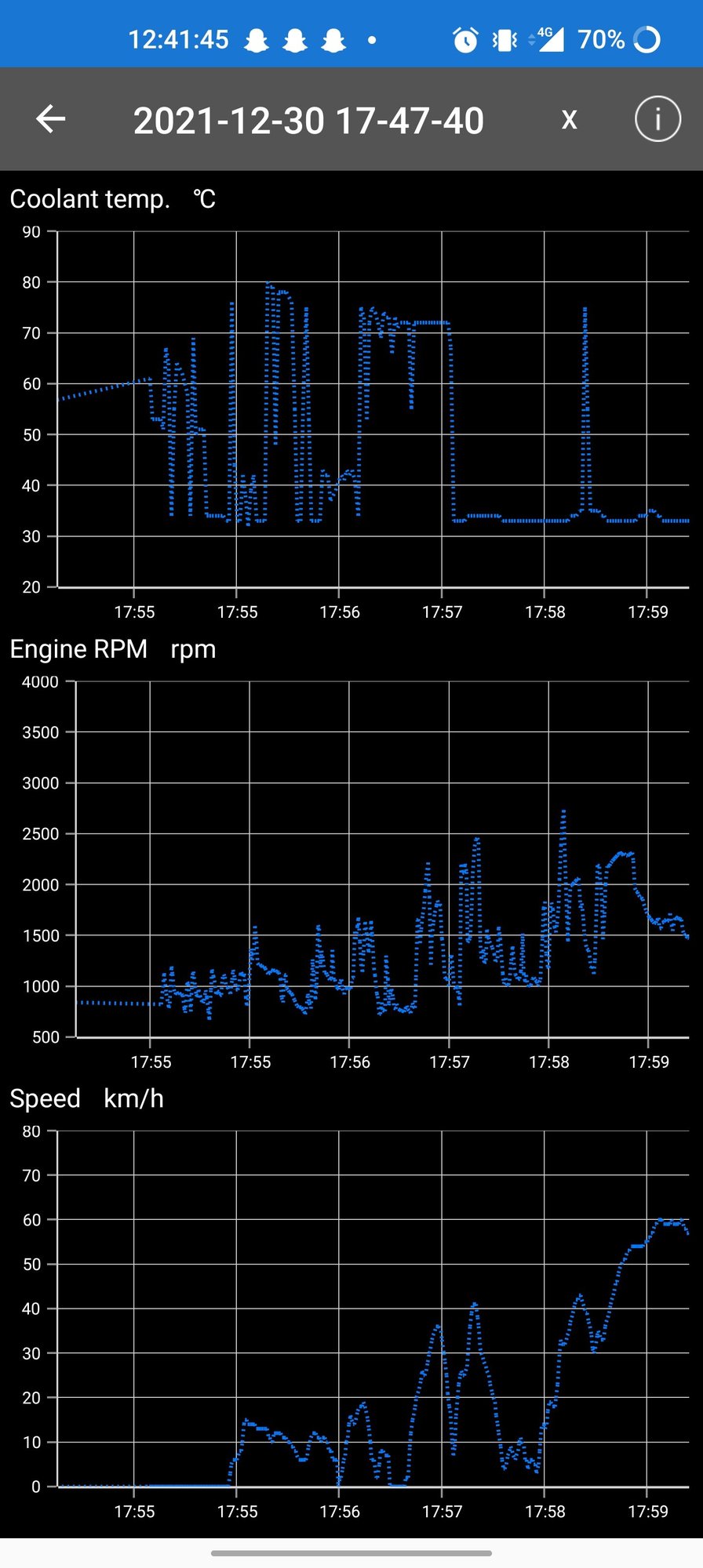

I can not really explain it but the temperature value wildly fluctuates like in this recording
Old Jan 3, 2022 | 08:43 AM
How about corrosion or a bad connection - or a 20 year old wire with missing insulation touching something or grounding out? Nice looking graphing software. What scan tool is that?
