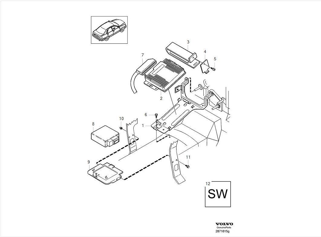

thank you for thew response Is the tcm located behind the radio ? or somewhere else?
Old Jun 16, 2022 | 01:01 PM
Likes: 541
TCM is #8
The TCM is #8
