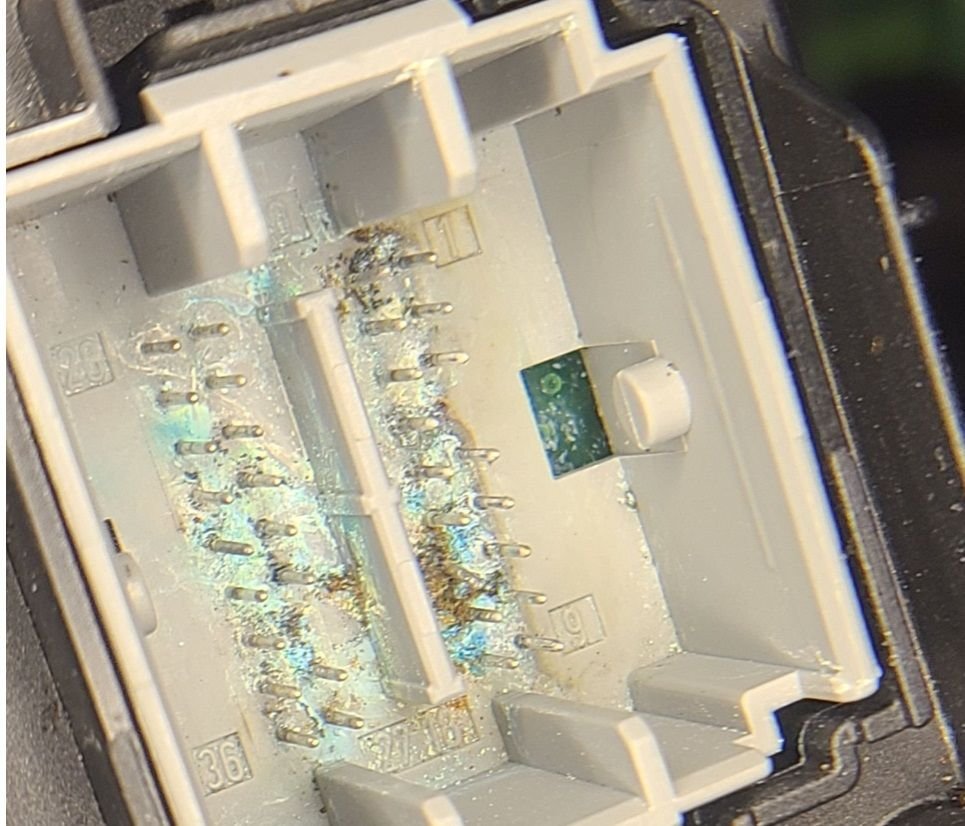

A good first step would be to scan the car with a compatible scan tool that can talk to all the modules in the car. With a bunch of seemingly unrelated happenings your CEM may have water damage or corrosion from water intrusion - A company such as xemodex can fix your CEM if needed.
