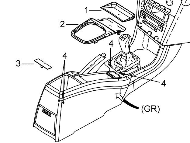

Ok, I did as suggested, all fuses related are good still, so I'm thinking something else could be going on, what else should I check? I am hoping I don't have to tear into the console as that would be a small issue at the moment

The center console comes out in a matter of minutes. Not difficult at all. You will also find the SRS computer under there.

Ok what's the easy way of getting it out? The car is the dd so it has a small window of time to be down

Remove the rubber mat under the radio
Remove the gear selector panel by pressing in the lugs
Set the parking brake
Remove the screw cover in the bottom of the center storage area (under your elbow)
Remove 2 screws in bottom of center storage area
Remove 2 screws holding front of center section to gear selector section.
Pull center section up at the front edge by gear selector
Remove power connector
