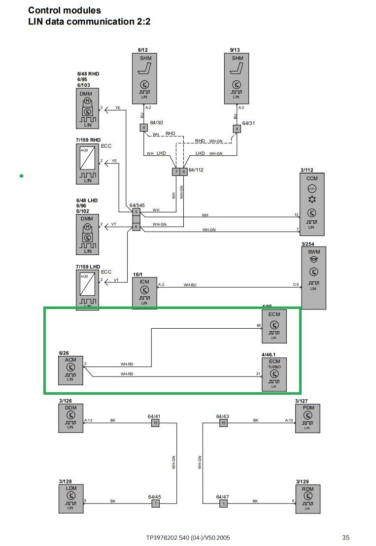

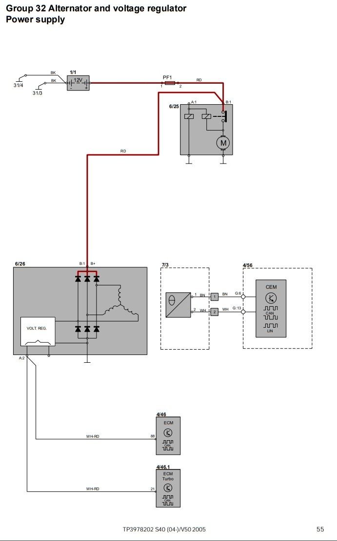

Older alternator circuits were simple. If the charging voltage was higher than the battery voltage - the light went out on the dash. The one small wire on the alternator went directly to one side of that dash bulb, and the big wire goes to the battery. .
That small wire now (in your car) carries a LIN (local interconnect network) signal. That signal goes to the Engine control module (both turbo and non- turbo ECM's are shown on the diagrams, there's not 2 ECM's in your car), is processed and sent to the CEM and DIM (dash cluster) over the CANBUS. (in the diagrams 6/26 is the alternator)
7/3 is the battery temp sensor - connected to the CEM. So the CEM can control the charging rate depending on the battery temp. (by talking over the CANBUS to the to the ECM if needed)
I'd bet your shop installed the wrong alternator. Yes it charges but is not sending the correct signal, or may not have have the ability to send the correct signal over the LIN, probably due to the voltage regulator in the alternator.
