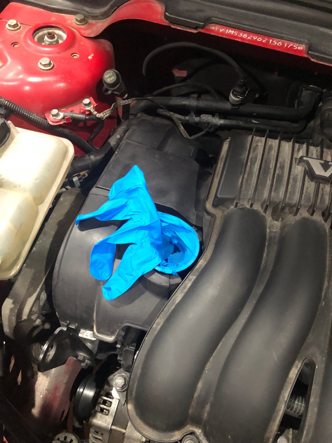

Also worth mentioning is I read somewhere to do a glow test over the oil plug. When I did that it sucked my glow in. Please see picture
Now I forgot, I was once told tat there should never be positive pressure in the crank case, what about negative pressure? When I remove the dip stick, the engine starts to make a hissing sound.

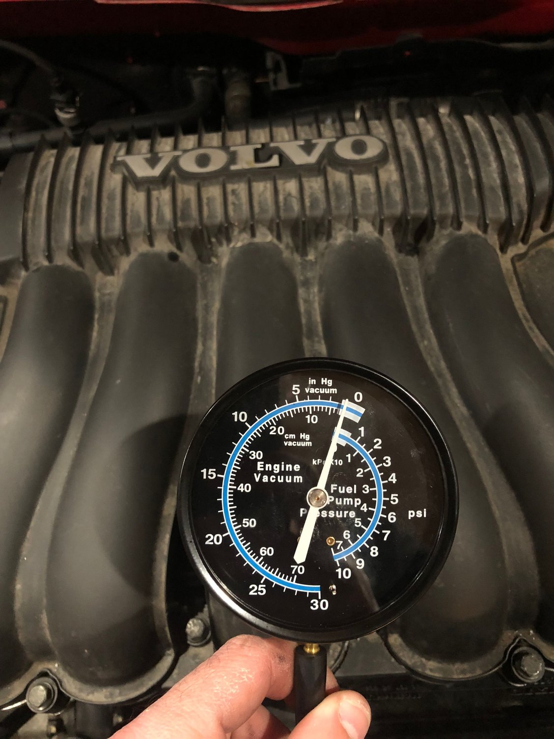

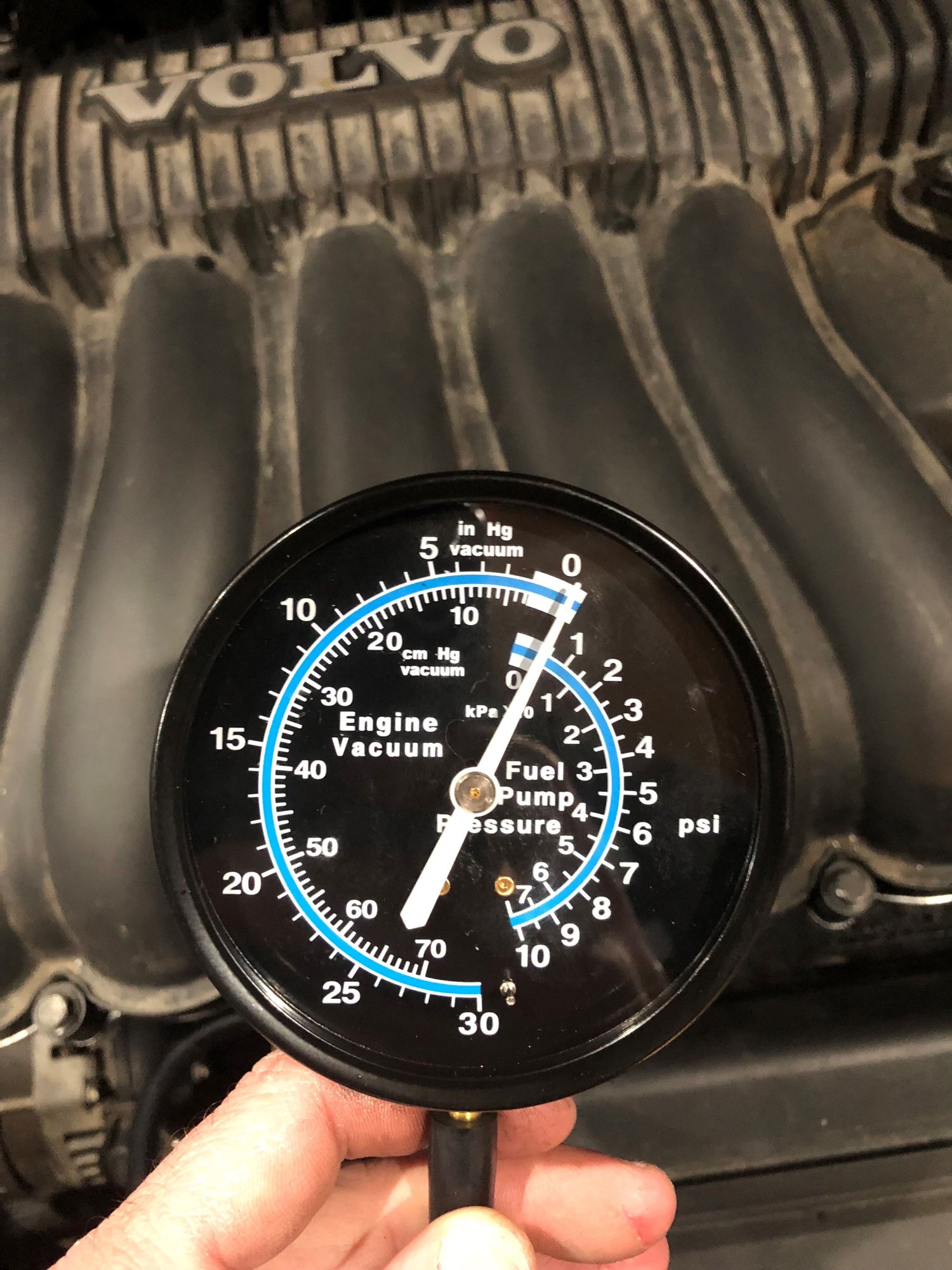

so I tried a vacuum pressure test but I can barely get the gauge moving. I was performing this test through the dip stick tube
car not running
Engine normal operating temperature (running)
I am not sure if this is a big deal or not but just wanted to throw this out there.
