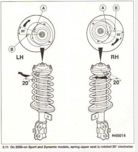

also note that the strut mount needs to be aligned rotationally using the hole in the mount and the base.

that is interesting...mine is the base model (1.6 slug/hardlyanygo/at/all) so is neither sporty nor dynamic.... I replaced the strut exactly where it was (did not move the steering etc and aligned the bolts precisely with circular marks which I made all around them when they were originally on. The wheel alignment does not appear to have changed...so mine seems to have self-located..I should get it tracked though..will after the next set of tyres..

I looked up my notes and I aiigned the holes under the top plate with the ones on the bottom of the strut, so that is why it fitted OK...mine does not have the provision for the 20 degree turn...I guess the T4 etc will...you never see those cars here now, probably all been crashed as they were really fast

as I recall, last time I re-installed mine, VIDA indicated that the 20deg only applies if you have sport suspension. For comfort you just align the holes vertically. I have a 2003 T4.
