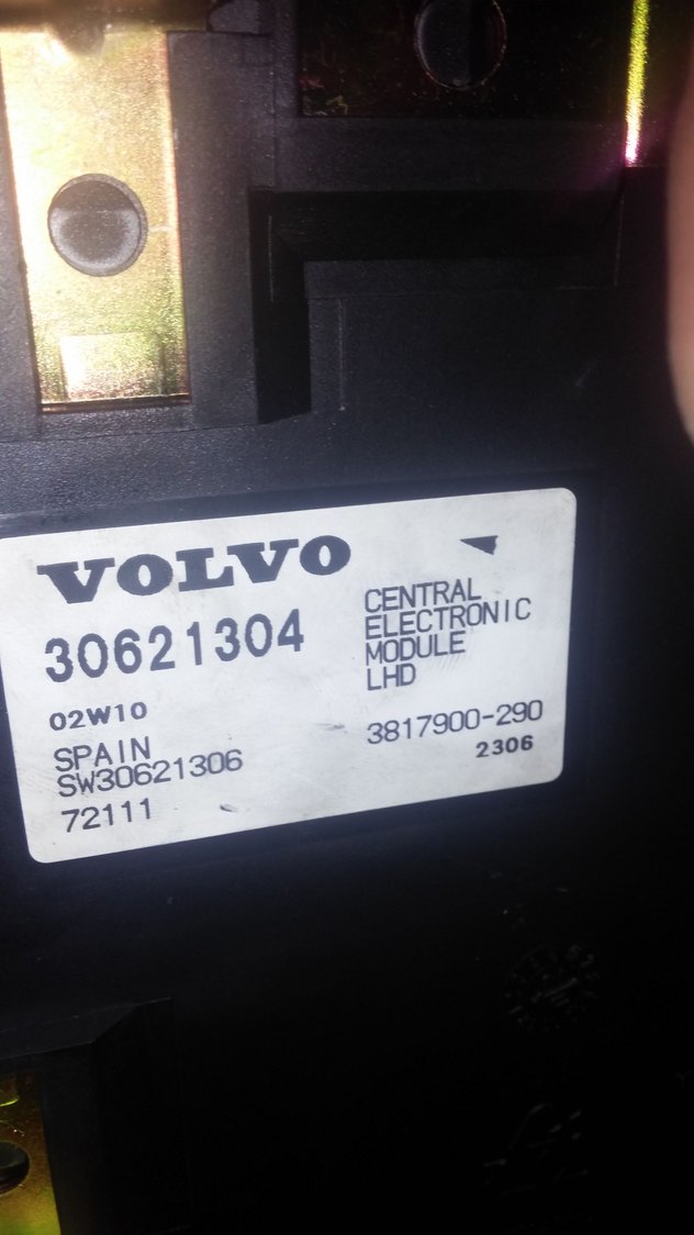

i changed it but no luck. Got it from a 2002. How do i match the part number

Sorry for the late response. Can you find me this ecu?

thats the CEM - the central electronics module holds a set of relays etc not the ECU. (ie the box down by the hood release). The ECM is part # 30614913.
Based on the fact you had to get a new key, I'd be looking into the immobilizer as the cause due to a problem with the ignition switch or key/ignition switch pairing.
