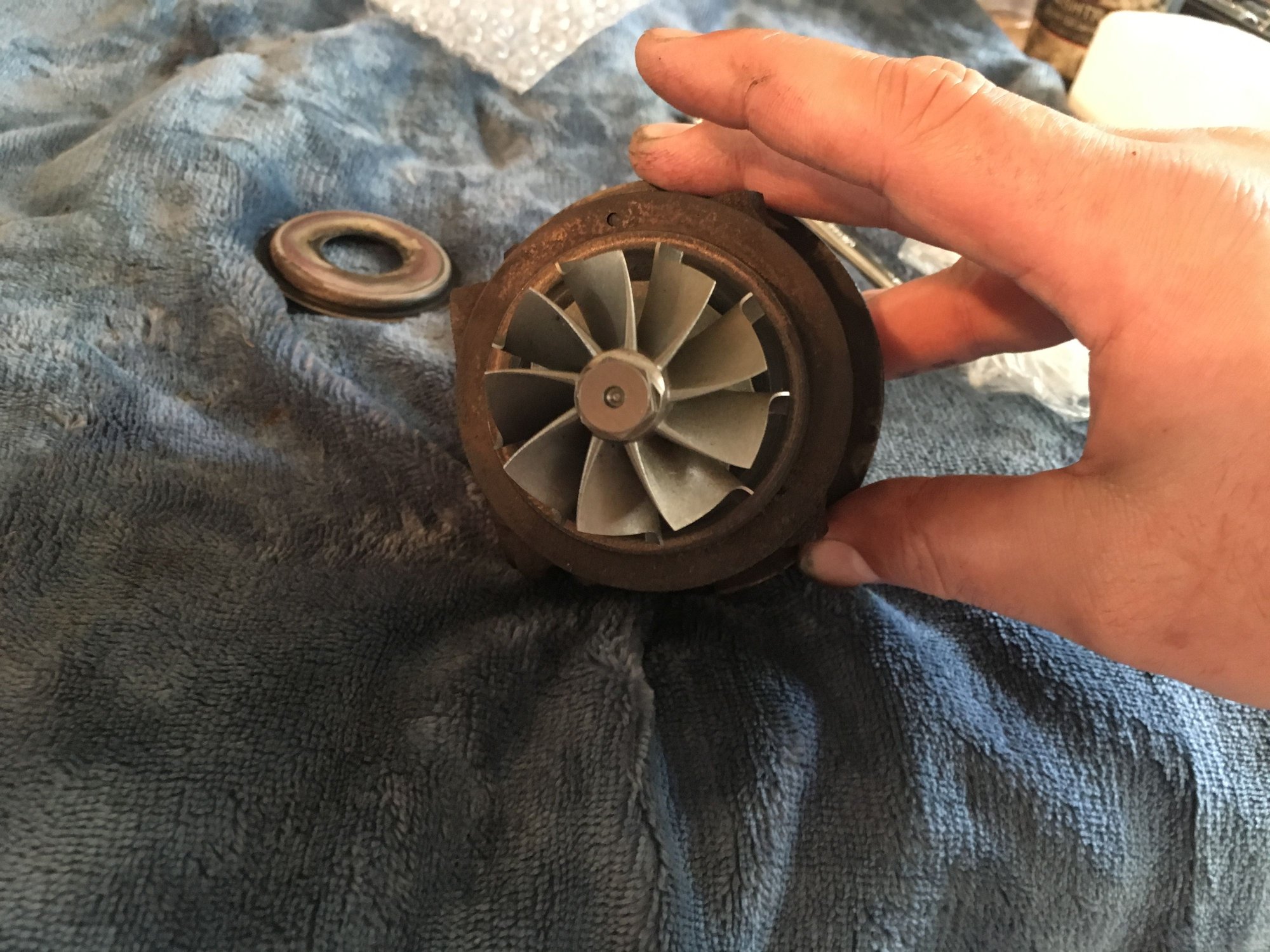

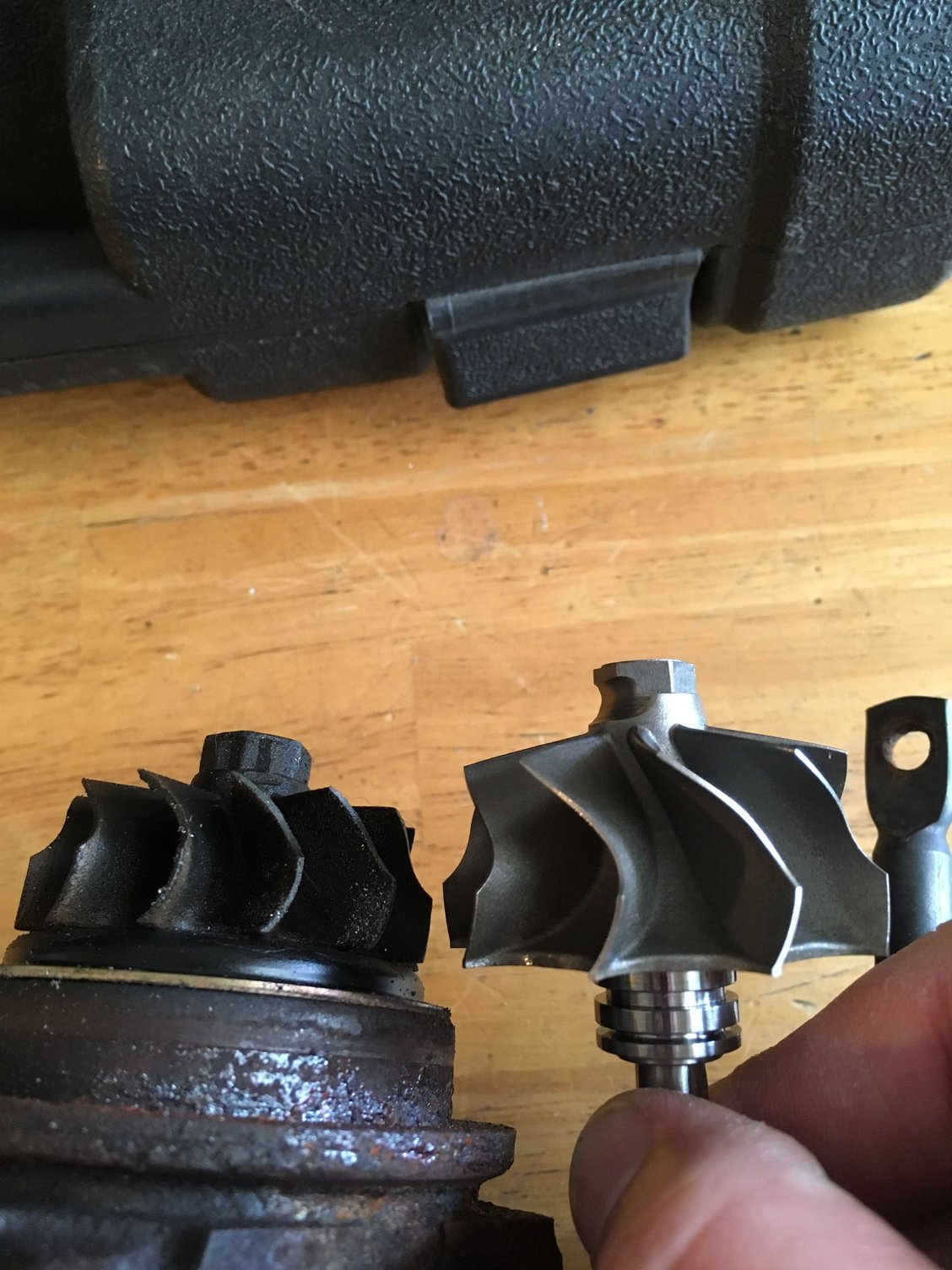

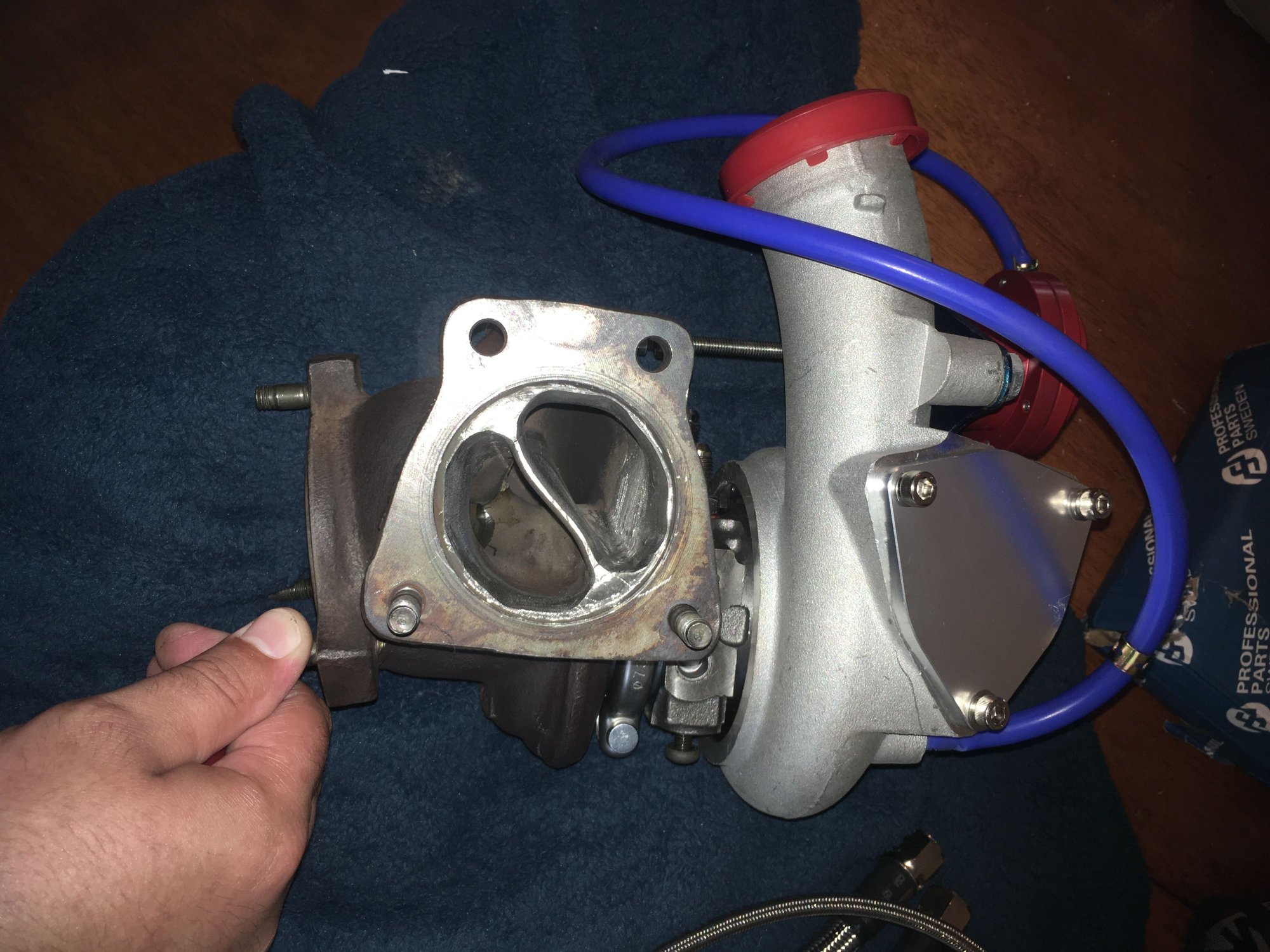

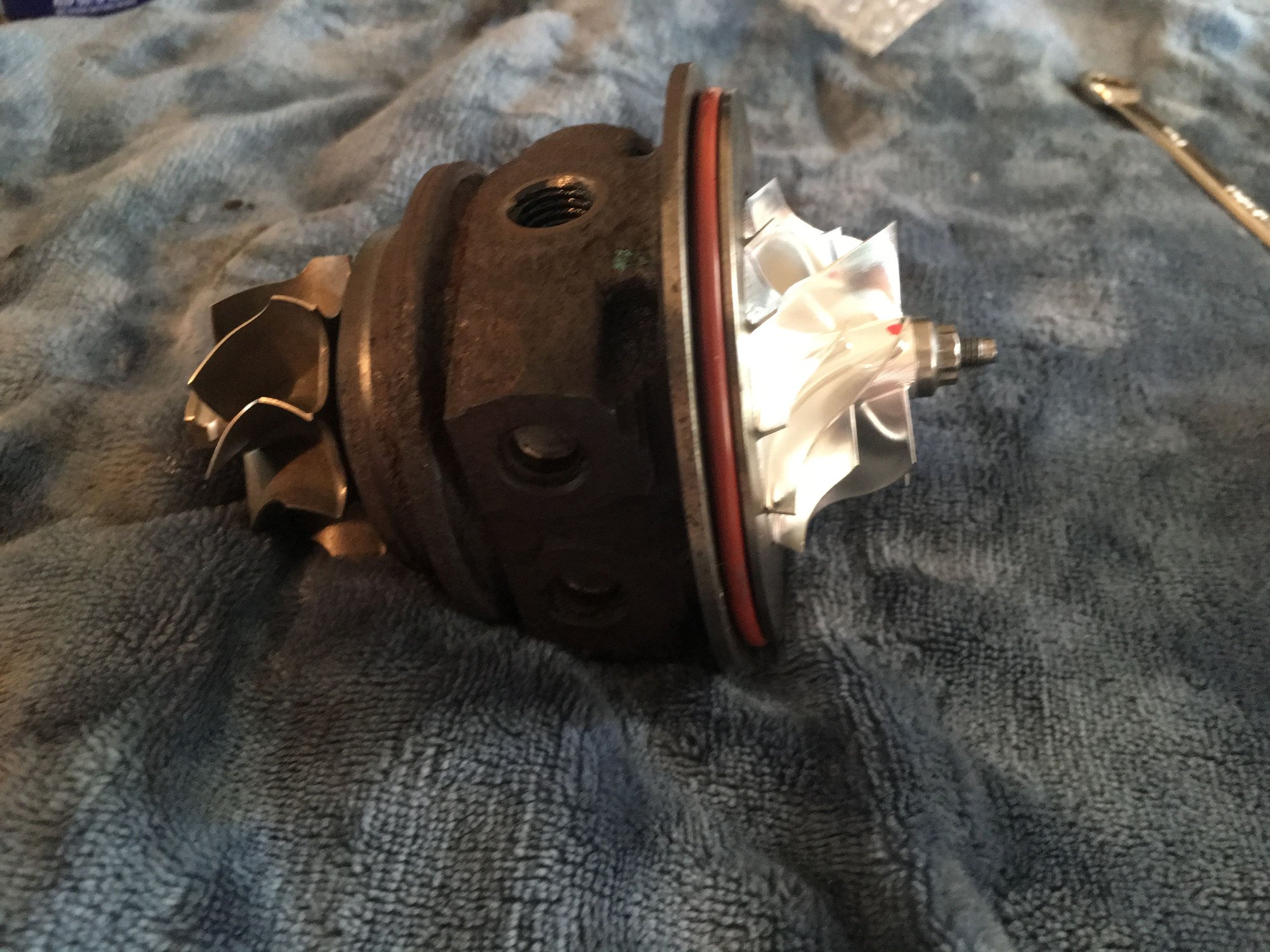

Default Turbo upgrade V40/S40 1.9T
Mamba racing sells a stage 3 kit for The Td04l 14T It includes a extended tip billet compressor wheel and lightweight highflow 9 blade extended tip turbine Along with forged thrust surface and collars and step gap piston rings The United States version has a 12T so i took a 14T from a s60 2.5T and rebuilt it with mamba 9-6 kit and swapped it over to my ported turbine housing and exhaust manifold mixed with a hollowed front cat and upsolute tune also running a billet mamba 14.5 psi wastegate actuator and billet cbv block plate with a hks bov and cheap short ram filter and the stock 440cc injectors handle it just fine along with the trans. I use E3 1 step colder plugs a walbro 255 pump and upgraded audi fpr 4bar. Rest of engine is stock and i run 14psi on 93 octane and make 277hp. Up over 100hp from the stock 165hp. Its pretty easy to get power out of these cars but anything more then 300hp and u will need to forge the engine.
