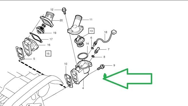

A 2001 does not have a PEM (fuel pump controller) The pumps runs at full speed all the time. If you had a fuel pump controller you would have a fuel pressure sensor on the left end (drivers side in the US) of the fuel fail as pictured below.
For a hard start -
What is the fuel pressure? What is the residual fuel pressure? (does the pressure leak down overnight?)
Any codes stored?
Do all the temp sensors report the correct temp? (air and water) with live readings on your scan tool?
I've seen poor connections on the early style coolant temp sensors, or erratic coolant sensors cause hard cold starting. Early style is the one on the right of the picture where the thermostat is replaceable. The left style is sold as a complete housing and I've not had to replace the temps sensor in those.
