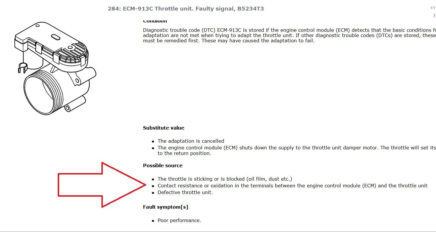

The 913 code - There is a known problem with the wiring going to the throttle unit - causing all sorts of problems. Many a not needed throttle unit has been replaced on those cars until the real problem was found. Volvo sells replacements - either the entire harness/plug as below, or wires that can be spliced into the existing harness.

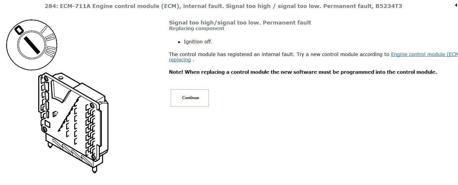

Your other control module code - My shops did not ever see a bad ECU in that year range - I'm sure it's possible - but might just be a bad connection. That would be the first place to look. If an ECU is needed xemodex can solve that for less than a new Volvo part.
Any different (new or used) ECU will not work in your car until it is "programmed"
