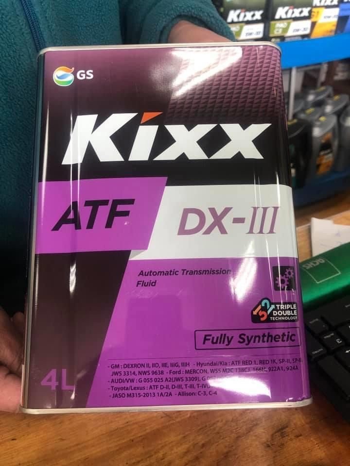

Lapschile's Avatar
Joined: Apr 2020
Default Kixx
Hello
I have a s40 2.4 year 2006 here in Chile. I applied this oil to 14 liters use as it was hitting when heating the oil to 85 degree. the pulls are still going tomorrow I will clean the selenoids and I will see what happens
