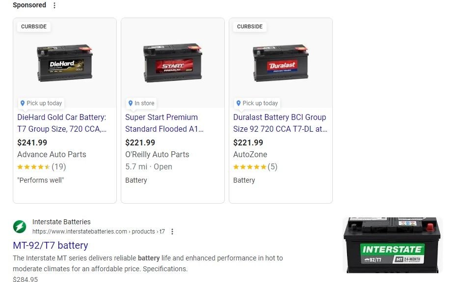

Buy the T7 battery. (to match what is already there, versus a H6) If not you (or he) may get a "low battery" message.
You should reset the battery monitor also.

That's a H6 size. You might get low battery messages if you use that one.
Buy a T7 (92) size to prevent that. Maybe walmart has that size.
