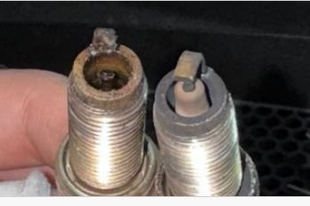

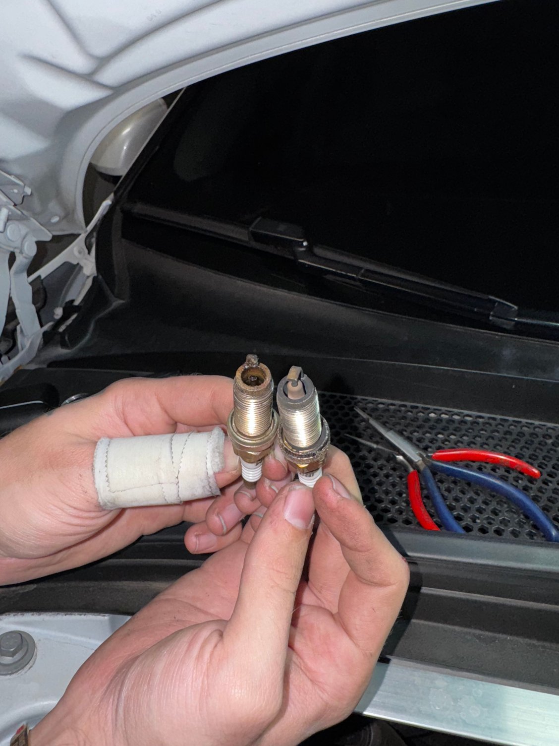

yeah very understandable, I had bought this Volvo a year ago with about 75k miles on it, trust me it was a lot of work to begin with since the previous owner didn’t really keep up with the maintenance before so it’s kinda all on me now, but when I took out the spark plugs they were denso spark plugs, not sure if they’re good or what but when I taken out the first one it looked competently blown, I have a picture to show as well. in no way am I guessing, I’ve called around & like I’ve said before I’ve gotten many answers but I may need to get it fixed if I cannot do it myself

when I removed the first one it looked competently blown,
OUch - those missing spark plug parts had to go somewhere - bounced around the cylinder. got jammed into the valve/seat, then possibly made it thru the turbo (without damaging it hopefully) and will be embedded into the catalytic converter.
Now you still have a misfire code on that cylinder. What's the compression?
