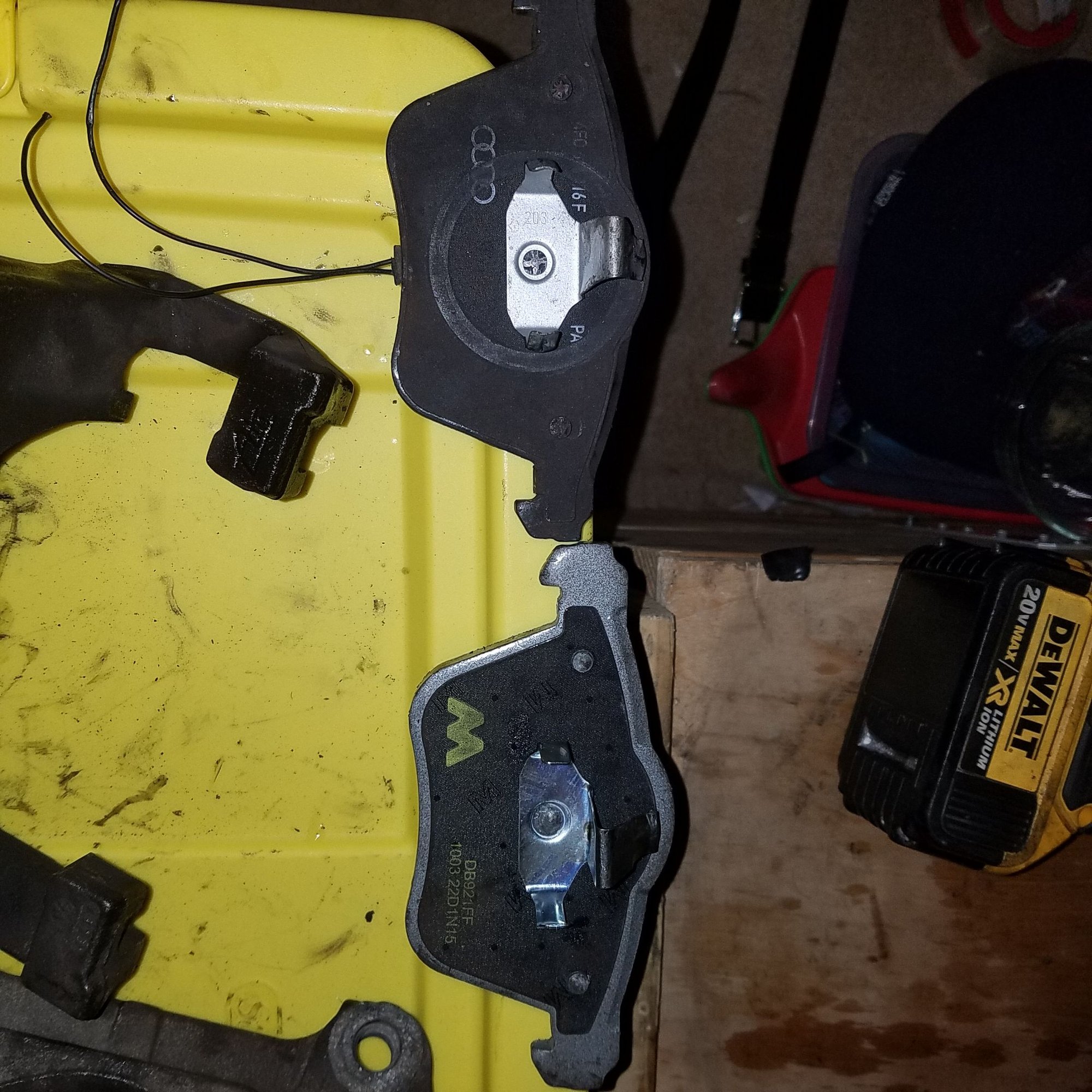

Also, while the S4 and XC90 pads are appear nearly identicaly, the mounting clips/prongs on the pad backing plates have ever-so-slightly different locations such that they cannot be used interchangeably because they wont seat properly (ended up using S4 pads, cutting off the sensor wires).
