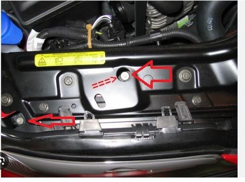

Want to adjust headlight on the passenger side (steering wheel to the left) vertically outward towards to the right side of the road.
In which direction should the outer adjustment plastic screw (vertical adjustment) be screwed, clockwise or counterclockwise for the right headlight to shine a little more side of the road?

Well - you will be looking at where the headlamp is pointing when you are adjusting it right?
Sorry - then turn it the direction you want it to go. If clockwise is wrong, then it must be the other way!

Yes, but it is difficult to access the screw and I can only turn the screw a little bit every time.
When I screw, i see no difference at all because I have to screw 10 times for each lap plastic screw to move one lap.

With a 6 mm socket on an extension - turn the white screws. One for up and down, the other for left and right. If the aim does not change - there is an internal problem with the adjusters.

I do not have holes on the top, but have to screw from the back of the headlights and the screw (vertical) is difficult to access. The white plastic screw is broken so I have to screw from the back.
Therefore, I wonder if anyone knows which way I will screw to direct the spotlight outward.
