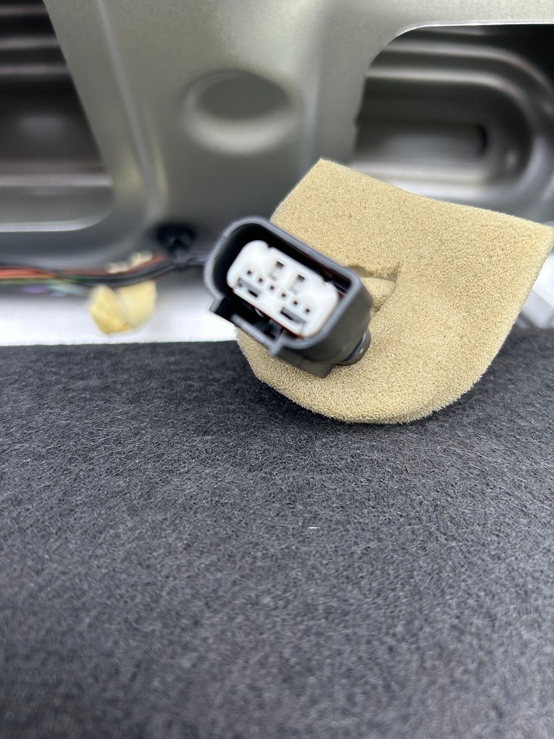

I found this plug in the trunk. Is this the plug for the backup camera?
Is this the plug for the Volvo backup camera? I hope so, it’s already run to the trunk
No - Here's the installation instructions - the camera wiring is already in the trunk lid - Note you will need a software download using a VIDA subscription to be able to make it (the volvo kit) work.
https://accessories.volvocars.com/en.../S60(11-)/2015
